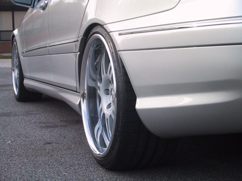

Finally had a chance to take a couple pics.
Hey all, just wanted to share the new add-ons…
DPE R07 VS rivet less, silver powder coat, polished lip
19x8 19x10
235/35/19 265/30/19 PS2
Rubbing? Yup, slightly at the rear fenders but fixable with a quick shaving. (on to do list)
Ride comfort? Really nothing too drastically different at all…slightly bumpier. I personally like it better.
Handling grip? Crazy fun!

Thanks!
More info to share:
With tires mounted, they each ended up being 5lb heavier up front and 10lb on the rear compared to the stockers…Boooo.

looks great! if u dont want rubbing. change ur tires will help too.

looks good! i would drop it a bit more in the front though

Yeah, I remember hearing that PS2’s are a bit square on the edges. I’ll shave what I can on the fenders and see what happens. Man, it better work. Which tires would you recommend by the way? Other options are good.

mistook ur dpe for hre
how's the ride compared to the stockers (18 right?)?
s-03 have pretty fat shoulders as well.. they'll probably rub

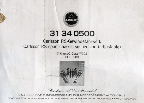

I totally agree. But the thing that sucks is… that's actually the lowest setting, perches all the way down. I think I was sold the wrong set of front springs. I scanned a pic of the labeling on the box I was sent. The item# on the front springs themselves are 31340503 and has the date 3/2004.
I wonder if anyone can confirm that I have the wrong front springs or not. The rears seem to be correct…plenty more room to go either way.

Yup, stocks are 18’s. The ride’s slightly bumpier if anything at all. There’s tons more lateral grip. But then again I went from bald Pirelli Rosso to fresh PS2’s. I can’t help it but to drive all crazy through off and on ramps even with the rubbing. I partly blame attending an AMG Challenge event.

Just checked on Carlsson's catalog....that's the correct part number
