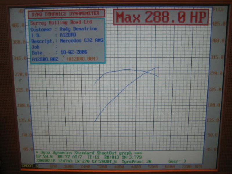

Could some one please explain this Graph to me, i Gather that the figure of 288.0HP is at the Wheels so whats the real bhp figures at the crank and the torque.
Mods are less resonator full SL55 air induction swap and a superchip ecu upgrade.
Thanks for your time and patience in assisting.

Andy, the flat graph is TQ, the one that is rising is HP.
Looks like you are making around 280TQ and 288HP. Dyno Dynamics dynos read slightly lower than Dynojet. My guess, on a Dynojet you would be around 295TQ/300HP, which just about right for your mods.

Thanks for the prompt reply buddy, what would the approx figures be for bhp and torque, not at the wheels.EU std spec is 354bhp and 331 ft/lb So what am i pushing out roughly ??

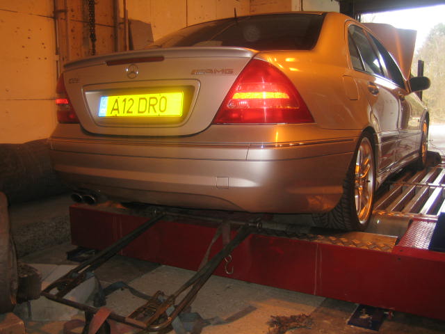

First things first, your C32 looks amazing!

You have to figure out the percentage of the parasitic lag in your automatic transmission, and that percentage is how much HP is lost through the drivetrain. I'm sure you may know this, but if you have the % you can figure out your exact flywheel horsepower. (all of this if your C32 is an auto)

What Vadim told you sounds right on except the fact that you may now have about 350+ftlbs of TQ at the crank now!

Hi mate, i would say from my experience with mercs, you have approx 355-365hp, and 357tq no more.. you must take in to account that ALL dino tests are diff, plus not forgetting the c32amg with its slow auto box absorbs bhp.

resonator and SL55 is about 7 to 9 hp to the wheels
the ECU is another 10 hp (Without the pulley)
the real gains are in the pulley kit.
Pulley kit alone is about 25 to 30hp to the wheels.
By the way, your car looks exactly line mine..
same drop, same wheels, same color... very NICE!
get the pullies Bro! and you will have close have 390hp+ at the crank (roughly 320+ to the wheels)

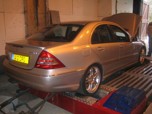

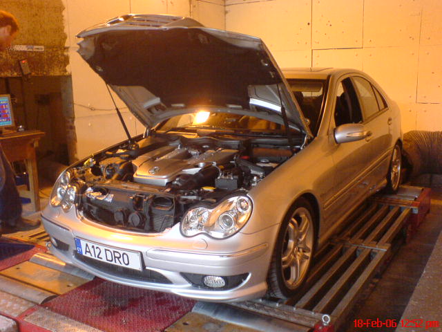

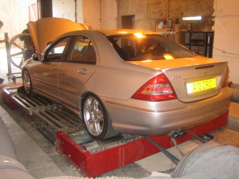

Would be great to compare graphs with others here to see the difference in upgrades & results please feel free to post them here.
Couple more pics too, video of the dyno coming soon, sounds nice...
