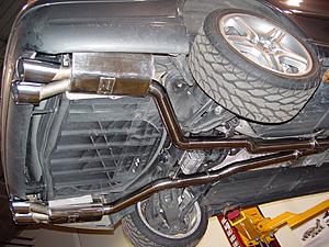

Originally Posted by AMG-Jerry
One problem is that AMG did a very good job on our exhaust. Another problem is that the C32 should have a dual exhaust all the way back. Our 2-1 setup makes for exhaust modding nightmares. I spent about $3000 on a custom exhaust setup and as of now, I'm back to my AMG muffler with an aftermarket resonator and 100 celll racing cats. The car seems to like where it is, but I will be doing a dual exhaust shortly. I can tell you from these pics that the x-pipe is too far back. A good rule of thumb is to put the car on a lift and measure the temps from the primary cats going back using a temp gun. When you notice a sudden drop in temps, you have found the perfect spot for the h / x pipe. For me, it was about half way between the primary cats and the resonator.

Well, an H-pipe will minimize back pressure by equalizing the exhaust pulses. The placement of the H-pipe is crucial. Like I said, the best place for my H-pipe was about 2 1/2 feet pass the primary cats. My mods are different and with the 100 cell cats, there is a good chance that your H-pipe will need to be closer to the front of the vehicle. If you can find a heat gun, you will be able to find the best spot. Just measure the heat off of the tubes until you find the magic spot. Your exhaust guy should know this trick....it's been around a long time.
An X-pipe does the same thing as the H-pipe, but it is more effective and less restrictive. The exhaust gases don't have to make a 90 degree turn, which is always good. The X-pipe is harder to place than the H because of its design. If you are going to do a custom dual 2.5" or 3" exhaust from the cats back, then I would suggest an H-pipe at a minimum. If you or your exhaust guy can squeeze in an X-pipe somewhere near the front, then go for it.
If you are not going to dual the car out, I would leave everything alone. The back pressure in the exhaust system can be your friend if you understand it. There are tools you can purchase to measure the back pressure and you can tune it accordingly. I will finish this project once I get my other mods done and post my findings.
If you want to move forward, read as much as you can on exhaust systems and back pressure. Here is a good article to start with.
Here is a link to an exhaust back pressure test kit.
I would treat the exhaust system on the C32 like any other area of the car. Don't install parts just because. Take your time and tune the exhaust accordingly. Measure your back pressure now and if you can't find a level of pressure that will provide more power, at least you will know what level has the most power and can adjust the pipes to get that amount back.
What may work for my car might not work well for yours. I lost 25HP when I started farting with the system and I was forced to figure out why. Don't make my mistake.

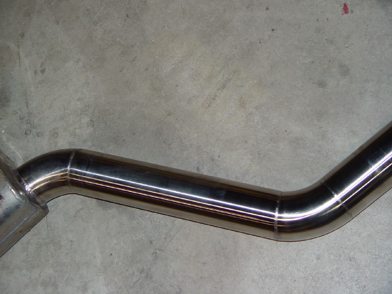

If I could design the system from scratch and $$ wasn't an issue, I would do the following (in order from front to back):
1. Port the Exhaust ports on the heads to match the headers
2. Purchase long tube or shorty headers with a 2.5" outlet (maybe 3")
3. Create a port matched down pipe with built in 100 cell cats
4. Add a flex section to the down pipe
5. Use same size Stainless Steel tubing to custom tuned X-pipe
6. Create a flanged section for easy removal
7. Add in two SS bottle resonators, one on each pipe.
8. Create another flanged section for easy removal
9. Use same size SS tubing from resonators to mufflers
10. Use free flowing non baffled mufflers with AMG tips.
There is nothing better than a SS exhaust that is easy to remove / work on.
Oh yeah...Don't use SS until you get the design figured out. SS can be expensive.
