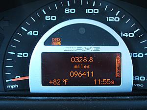

I'm really sick and tired of resetting my CE light on a weekly
basis for this P0410 fault code. I wonder if there's a way to
get the dealer to change the pump, relay and NOT touch the
software.

Off
warranty?
replace it yourself
http://www.autohausaz.com/search/pro...20@Smog%20Pump
ecu will re adapt.
