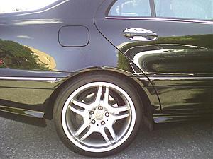

well i installed my H & R coilovers with the help of a tech friend of mine from the dealership. The install was actually not as easy as i thought it might be. you HAVE to have that special tool for the top screw adjustment.
Also, you are supposed to remove the rear height adjustment pad, but i'm not totally sure i'm happy that i did.
the rears are adjusted up as high as i can get them. Not sure i'm ok with the drop. I really didn't want to drop the rear at all. I may put the pads back in (after i modify them to fit the adjustment piece at the top of the spring) and then adjust from there.
the fronts are pretty low, but i think i like them. the car is NOTICABLY lower when i sit in it, and when i get in and out of it. I may raise the front just a little bit too, but i haven't decided. I don't want my car to look too much like kid who's trying too hard to look cool. hmmmm i'm 35 and lowering my car- i guess i'm still a kid.
THE RIDE. The ride has not changed much. I thought it would be much more harsh, but it's really not. You feel bumps a little more, but not much. The car just feels tighter. When i hit a bump, i feel it, but the car feels like a tank.
THE HANDLING. Really great. I took an on ramp to 422 here in Pottstown, PA at around 75mph today, and I'm not sure i'd have tried that with the stock.
THE LOOK OF THE CAR. i think it took it from a sporty mercedes to a sports car, very quickly. Like i said above, i'm concerned it's a little over the top.
DRAWBACKS???? i bottom out coming out of my development now, but in some wierd way, that's kind of cool to say "yeah she bottoms out cuz she's just so damn low to the ground...."

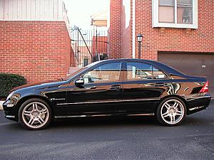

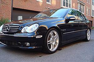

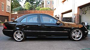

Here's pictures of before and after. Everyone's comments are welcomed.
I can tell you anything you need to know about the install as well......
Attached Thumbnails just dropped with H & R coilovers... pictures, and everything else you want to know-after-small-3.jpg   just dropped with H & R coilovers... pictures, and everything else you want to know-c32-spoiler-thanksgiving-2005-013.jpg   just dropped with H & R coilovers... pictures, and everything else you want to know-front.jpg   just dropped with H & R coilovers... pictures, and everything else you want to know-rear-resized.jpg

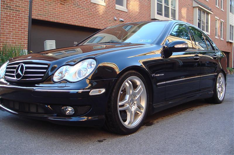

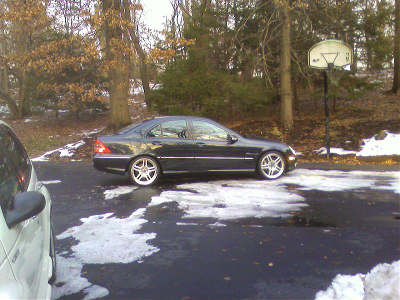

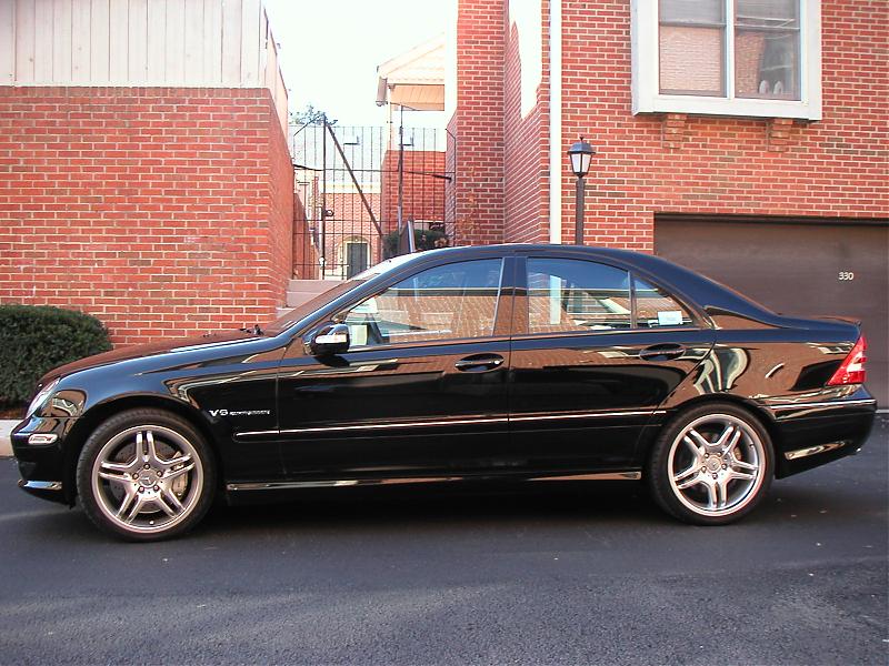

here's the before....... in higher quality
Attached Thumbnails just dropped with H & R coilovers... pictures, and everything else you want to know-c32-spoiler-thanksgiving-2005-019.jpg
Old Oct 4, 2007 | 12:09 AM
danielemccabe's Avatar
Joined: Nov 2005
Posts: 348
From: West Chester, PA
2010 C63 P31, 2003 C32

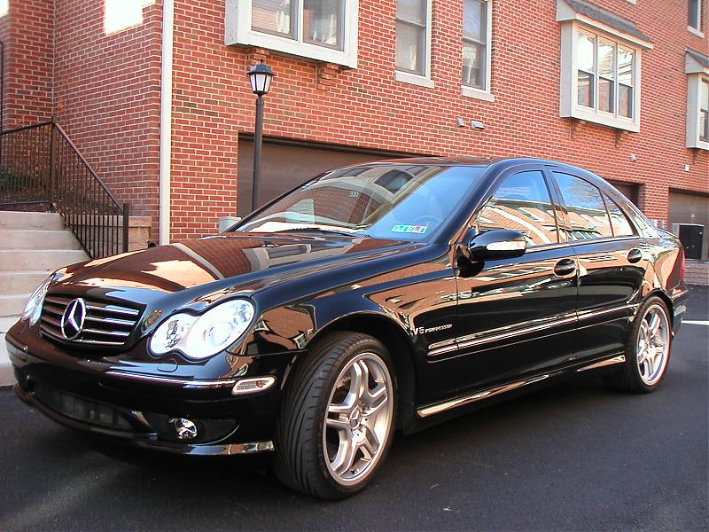

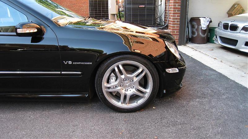

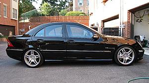

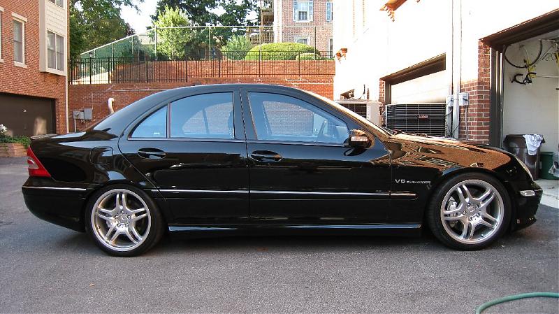

here's the after...... in higher quality
Attached Thumbnails just dropped with H & R coilovers... pictures, and everything else you want to know-small-change.jpg

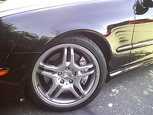

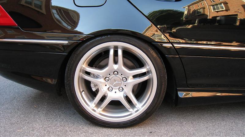

Did you replace or paint the real calipers? They look very clean for an 03 model.
Old Oct 4, 2007 | 10:50 AM
Joined: Nov 2005
Posts: 348
I paint the rear calipers every 4 months. makes them look like new. i use aluminum high temp paint. makes a huge difference.

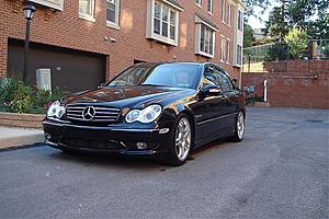

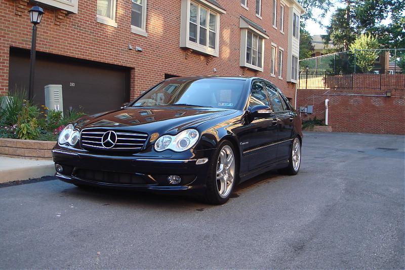

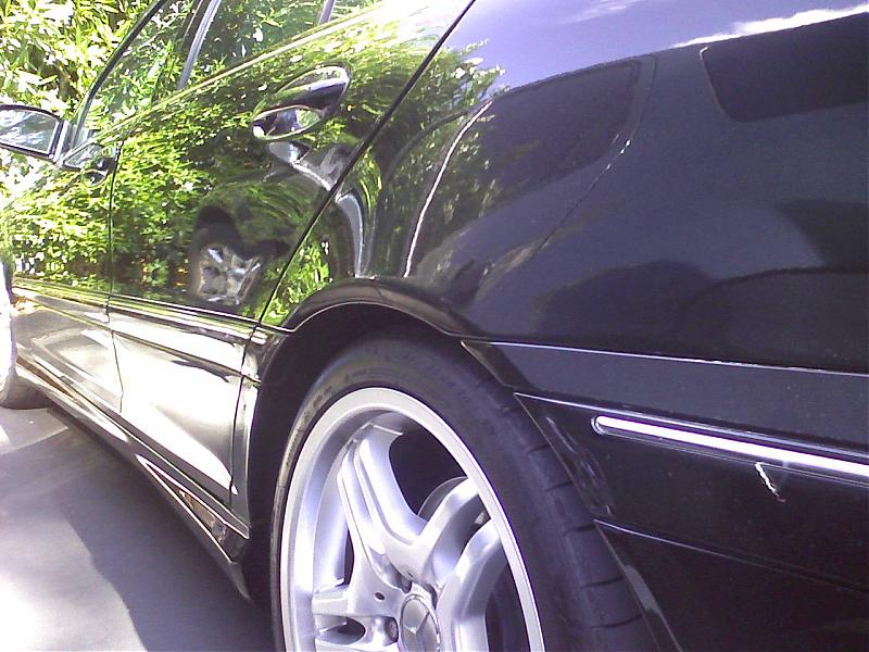

here's the front end after the drop and after a wax...
Attached Thumbnails just dropped with H & R coilovers... pictures, and everything else you want to know-front-less-pixels.jpg   just dropped with H & R coilovers... pictures, and everything else you want to know-front-less-pixels-2.jpg

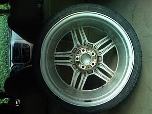

do you have any more pictures of those Bremmas? they look great.

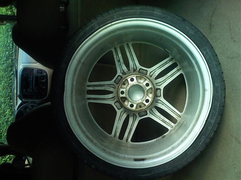

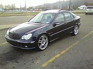

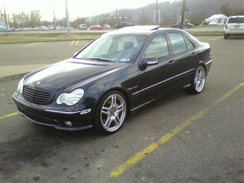

I dont have too many good pics, but ill throw up what I do have. I love the wheels but around Pittsburgh they bend like a tin can. Ive had this set for about 5000 miles and the front right wheel, the one pictured is bent badly in 3 different location...along with other wheels. Im one of those people who dodge every pothole and drive 1 mph over speed bumps but when I step on it and get careless I never seem to catch a break. The only upside is that the wheels are cheap to replace (as compared to a real set) so it doesnt break the bank when you nail some 6in deep pgh manhole. They fit great, no spacers, clear amg brakes...I can send you the link of where I found them the cheapest and purchased them if you are really interested
Ive been painting my rear brakes with high heat black paint for a year now, never thought to grab a can of silver...looks good
Attached Thumbnails just dropped with H & R coilovers... pictures, and everything else you want to know-img_0086.jpg   just dropped with H & R coilovers... pictures, and everything else you want to know-sspx0041.jpg   just dropped with H & R coilovers... pictures, and everything else you want to know-sspx0084.jpg   just dropped with H & R coilovers... pictures, and everything else you want to know-sspx0022.jpg   just dropped with H & R coilovers... pictures, and everything else you want to know-sspx0021.jpg

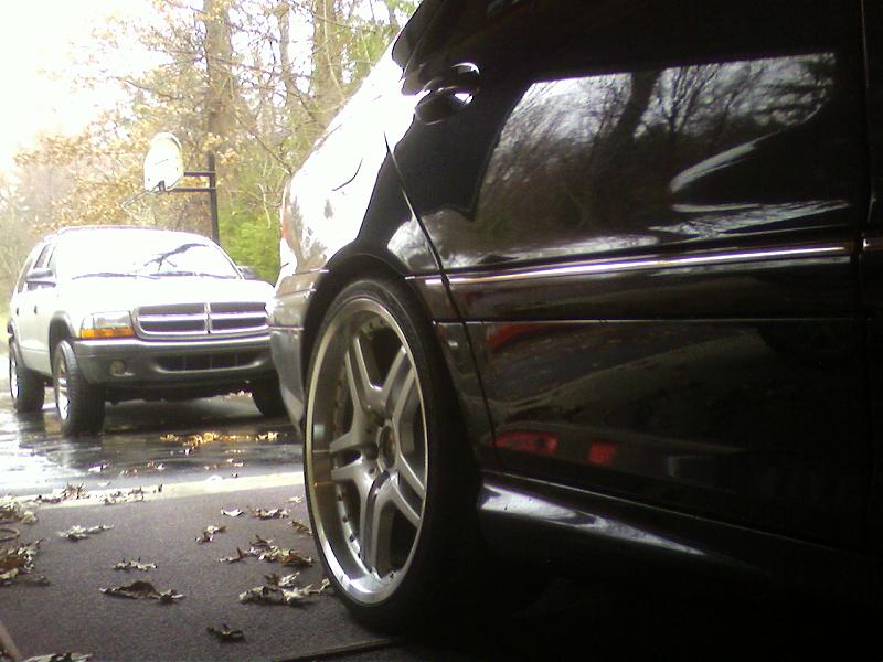

The C55 is definitely lower, but I can't tell you by how much. I was looking at trading my C32 in for a 55 and watched one roll in from a test drive. It looked quite a bit lower but they told me it was stock.
I just installed my H&R coilovers and used rear spring pads (#4) rather than the adjustment collars because H&R sent the wrong bearings (or someone at Tirerack raided the box). It's too low for me and I will probably go for the collars, which I'm told will give me back .5 inch of rear ride height.
I will snap a few pics or I might just wait until I switch to the collars.
And one more thing, which I will post with my original thread but it may interest some here, is that my spongy feeling suspension, which wasn't
diagnosed correctly by the dealer or the tire shop that installed my new tires for me, turned out to be shredded strut mounts.
I love how this car handles now, and it is the first mod I have done. I couldn't be more pleased.

My tires are up into the wheel well with the pads. The mechanic told me I would gain .5" if I put in the collars. Your car looks as if it sits higher than mine in the rear.
I live in a somewhat hilly area and have an incline to my driveway. I will bring my camera with the car and snap some pics on level ground, hopefully today.
