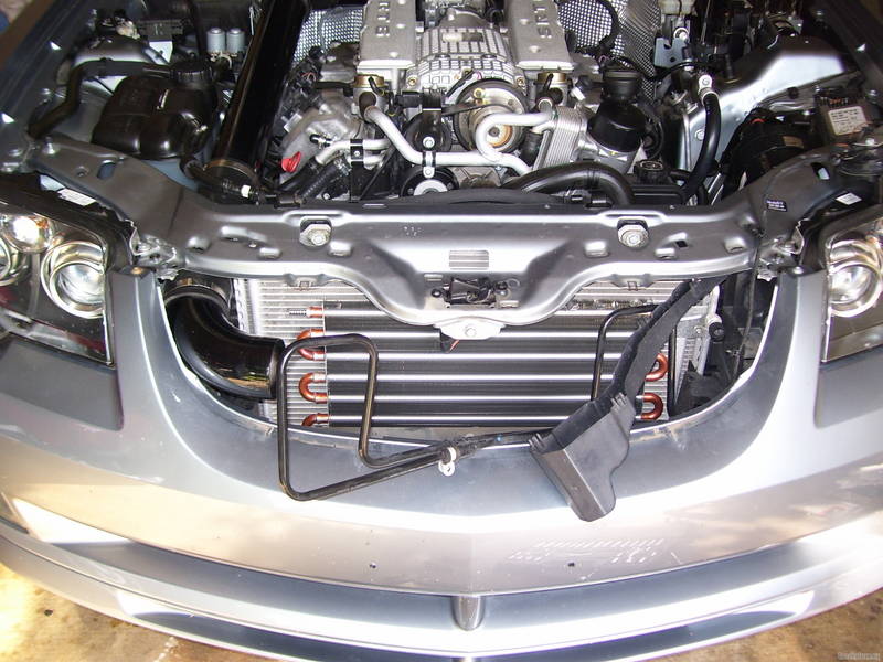

I took it a step further with my SRT6. Added a 20x10 transmission cooler in line with the factory heat exchanger and two 450CFM 7.5" SPAL fans. Also Isolated the IC system using a one gallon fuel cell. Did some datatlogging the other weekend. Ambient temps were in the low 90's, intake temps stayed around 10 degrees above ambient with the fans and johnson pump running. I haven't gotten the chance to see how much some ice in the tank will drop the IAT. BTW I have the ASP pulley set now as well. Here's a couple pics of when I was mocking up things. I'll have to get some pics of the finished product.

Very clean looking install there! Well done! I think y'all have a little more clearance up front on the SRT-6, right?
I'd definitely be interested in seeing an in-detail writeup on your mod set-up along with some data-logging when you have the time.

Not quite as clean as I had it the first time, but I had to move/remove some things to fit the filter for my 3" intake. There is about 3 inches of space in between the frame and factory AC condenser. Enough to fit the cooler, the fans and still have an aprox 1/4" gap.
I don't know when I will get some datalogging in becasue my brand new laptop had to be sent back and I just bought a brand new 5.7 Tundra which I have been enjoying and looking at a few upgrades for it. Too many toys! Once I get around to it I'll try to post some numbers.
