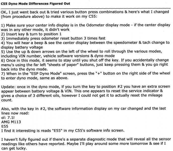

i waz at the dyno today and ran in to couple problems. First we couldn't get a rpm reading but tuned in the roller speed to match the rpm.2) when i followed instructions to put the car into dyno mode as shown https://mbworld.org/forums/c32-amg-c...no-mode-2.html the screen came up, i high lighted dyno mode and assumed it waz in dyno mode with it high lighted, or is there a enter button? then i tried doin a 4th gear pull in m mode and the car waz not aggressive at all it took a good 40 secs to run it up to red line and only made 221hp lol but 337tq at 3500 ft above sea lvl.not to mention my abs light came on. Can anyone help me out?

This is exactly what I went by:

i followed every step, heres what the car does i put in m mode, 1st gear pulls hard 2st pulls hard 3rd same 4th its revs up slow like good 60secs to hit red line from 3000rpm call me crazy but it just doesnt feel right

When I did mine it also seemed to take a bit longer in 4th gear to reach redline (while in dyno mode). It should be noted that I didn't just floor it as quick as possible when I reached 4th either, but rather did it in a gradual manner. This worked consistently for me on a Mustang dyno. What kind of dyno are you using?

They hooked my car up for an rpm reading. The operator told me that on a Mustang dyno, once I'm in the proper gear (in this case 4th), that it really doesn't matter how long it takes to get to redline (within reason) and that the reading should still be an accurate one. Is there a Mustang dyno nearby that you can try?
