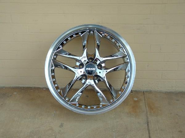

Do these wheels fit C55 AMG? MAHDI CAESAR TS5 BY NAPRE JAPAN WHEELS 19" "STAGGERED" 19x8.5 front +40 offset and 19x10 rear +44 offset 5x120mm bolt pattern.
I am buying from some individual and he doesn't know...
You input would be greatly appreciated!

They wont fit a C32 so my guess is that they wont fit your 'Five-Five". I am running with 30F and 35R with my 19's.

a 5 x 120 bolt pattern is BMW or Camaro.
Benzes are 5 x 112.
Plus the offset is way off anyways.
Are you sure the bolt pattern is correct? I have seen many JDM cars (5 x 112) running with this style. However i have seen one C55 with this rim on the board. Check the photos sticky at the top of the forum.
