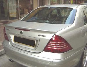

heres mine

Mine looks the same. Do Australian cars have rear fog lights?
yes only the one rear though looks stdupid in my opinion so gay why ot just have both fog lights rather then jst one, and then let us have the option of using the fogs or not however we please, but i understand why its annoying it looks like we are constatly braking or a bulb has gone out pretty dumb, i am in the process of making both fog wprk in the leds when i get them modded
just want ny car perfect
