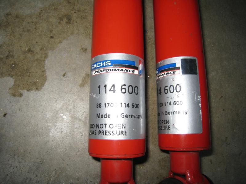

Indeed..

I think the best way to go is the Renntech suspension. Will give you an inch drop without ruining the ride and your alignment (my alignment is actually better now than it was before the drop!). You can buy the springs without their shocks/struts but I would recommend getting those, too. I thought there was someone selling a set of at least the struts in the for sale section. I'm looking to get some swaybars next and this car should be really fun!

Agreed, however I was unable to find C55 specific ones. They seem to have ones for the C32 however. 91RS do you have the part #? The part number for the C32 ones are 32_203_20_95
Ah, I didn't know there were different ones for different cars. I thought the only difference was the size for the sway bar end link bolt hole. If that were the case the hole could be made bigger rather easily. I actually don't have the part number for the fronts since I bought mine used and I didn't see any stickers on them, but the rears have this number on them.

all W203 suspension are interchangeable. The renntech shocks will work for the C55 as well. The renntech shocks however is made by SACHS which is the same company that makes the AMG shocks.
as for the AMG performance suspension. since they're made by KW, if you want coilovers...just go get the KWV2 or V3. They don't make much of a difference vs the AMG performance one. The main thing is the AMG ver. has AMG's take on spring rate.
