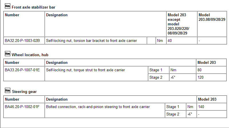

Anyone know the torque rating for the lower control arms (properly called torque and thrust arms)? I dont have a service manual.

This is all I could find searching the Service DVD. It can be hard to locate information on that thing...
Thanks a lot, at least gives us an idea. I might stop by and ask my SA. BTW I just ordered the control arms from Pelican Parts for $58.00 each. The Brand is Karlyn (don't know if they are any good), but the price is very good.
I think the information you are looking for regarding the torque strut may be in the service file below. I'm posting the entire file as jpeg thumbnails just in case anyone wants the protocol for removing / installing it:
OMG man, you rock!!! Thank you I'm going to tackle it this weekend.
