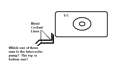

Can someone tell me which one of these hoses runs to the intercooler pump?
All,
I just finished installing a new alternator and as I installed in I removed two coolant lines/hoses out of the way to make room and now I cannot remember which one goes where. If you look at the front of your engine, you'll see two metal coolant lines emerging near the left bottom of the supercharger that have standard rubber hoses clamped onto them.
One I can see runs down to my intercooler pump, the other appears to go toward the radiator or H/E. Which one of these runs to the intercooler pump, the top or the bottom one?
Thanks, I'm about done here but don't want to reverse these.
Attached Thumbnails Can someone tell me which one of these hoses runs to the intercooler pump?-collant-lines.bmp

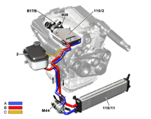

Check the attached picture.
Attached Thumbnails Can someone tell me which one of these hoses runs to the intercooler pump?-icfluid.gif

perfect, thanks!

I labeled "T" for "top" and "B" for "bottom" on both the tube, and metal pipe.
