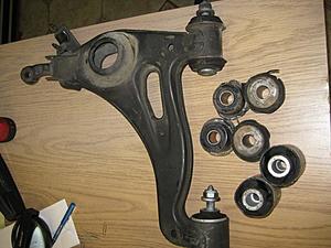

I apologize if I gave incorrect information. My car is a 2006 (Crossfire) and I know many models of MB's use the same bushings. Mine aren't fluid filled. I even drilled one to be sure. The picture shows the originals that came out of my car, the original A arms with the replacement bushings. The part number on the originals is 202 333 64 14 the replacements I purchased are A 170 330 00 75. Currently I have Kmacs on the car that I installed in a spare set of A arms. Who has the part No. for the C55, out of curiosity?
Les
