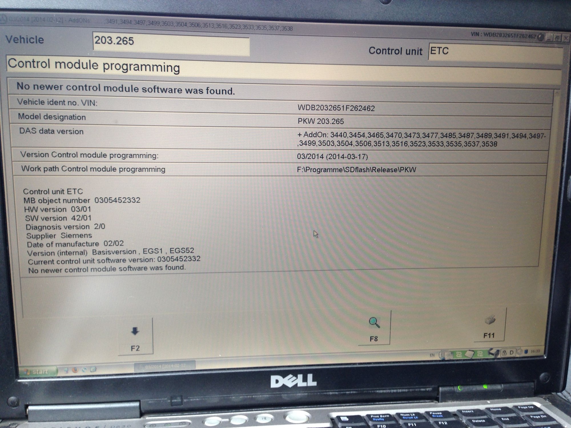

Today i have a little bit of progres!

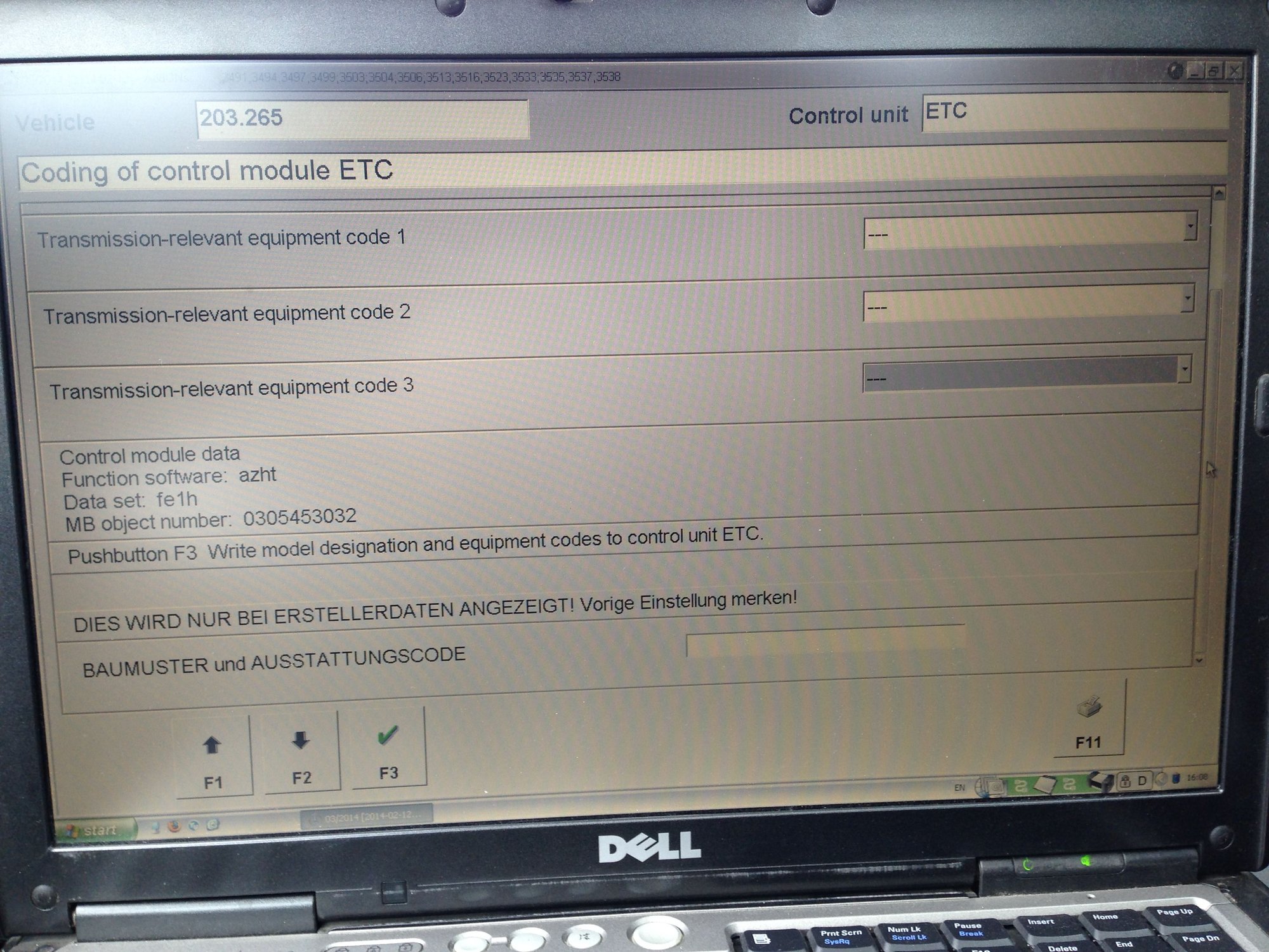

trough developer mode of my STAR machine i enter in menu coding>SCN Kodierung PKW
And there was a drop menu with a lots of codes. My original code was AH04
Disconect myne and conect the TCU that i take from a diesel model, open the same menu and check the code - AQ08
So i chose from the drop menu AH04, and the car drives like it should be, no limp mode, no out of sequence gear changes!
I want to ask specialists, is this the "coding" of the TCU that needs to be performed in order to get the C55 TCU working in my C32 ?
Or there is other more complicated things?
There was other menues with codes and some other things on German, but i did not massed with htem. Here are a pictures, maybe someone can help with info?
This is where i chose AH04 like was on my original TCU
The rest of the photos are of coding options which i don't know what to do..
Here you can chose from the drop menus if the car is code 030 AMG, if it's European etc, if it got paddle shifter and more

the scn code u change is for differential ratio, u set the other tcu to take the same diff ratio and it took it cause the car it came from has the same can bus, but u can't change other options like shift rpm or manual mode, those options are in the software/flash.

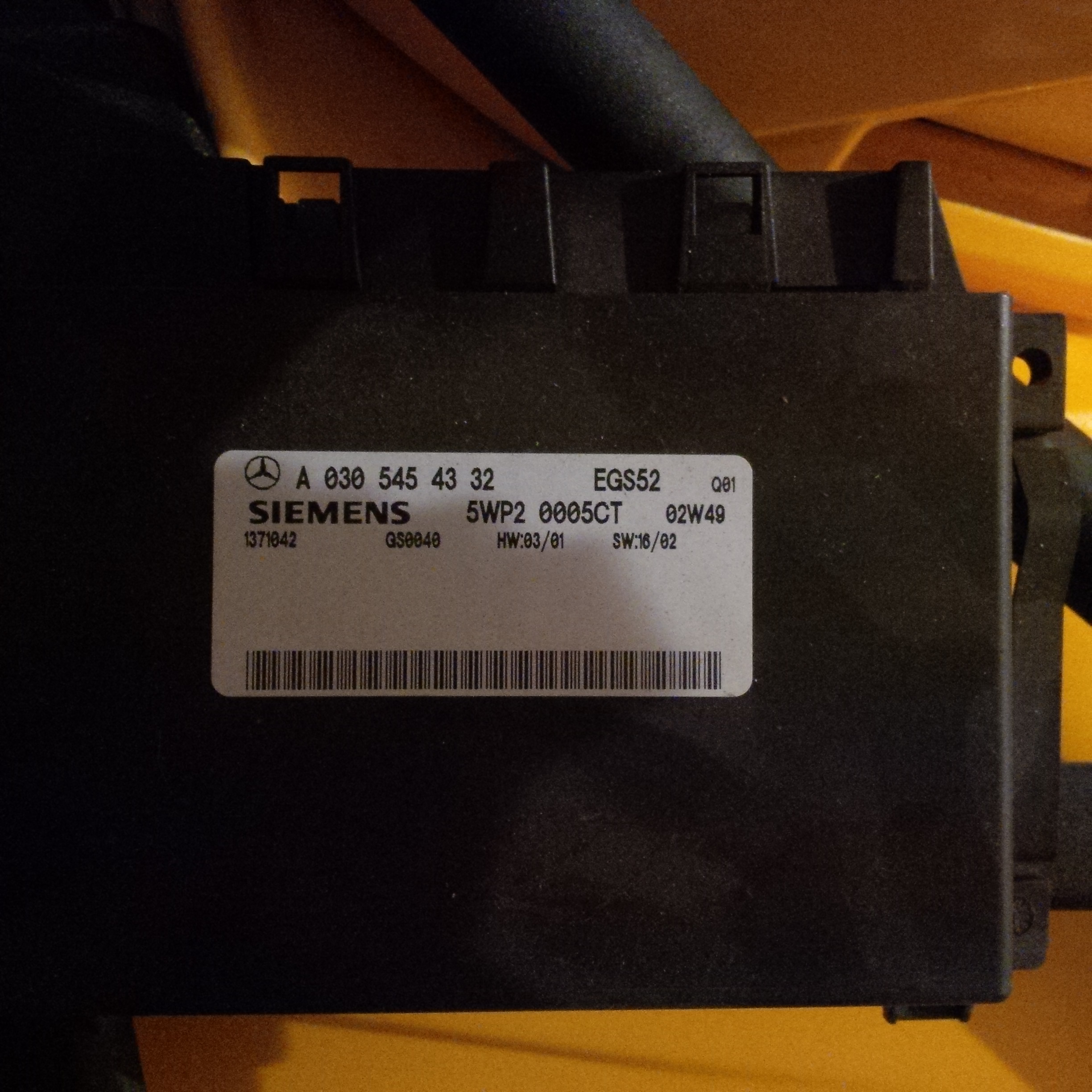

Clk 55 03-04 TCU
