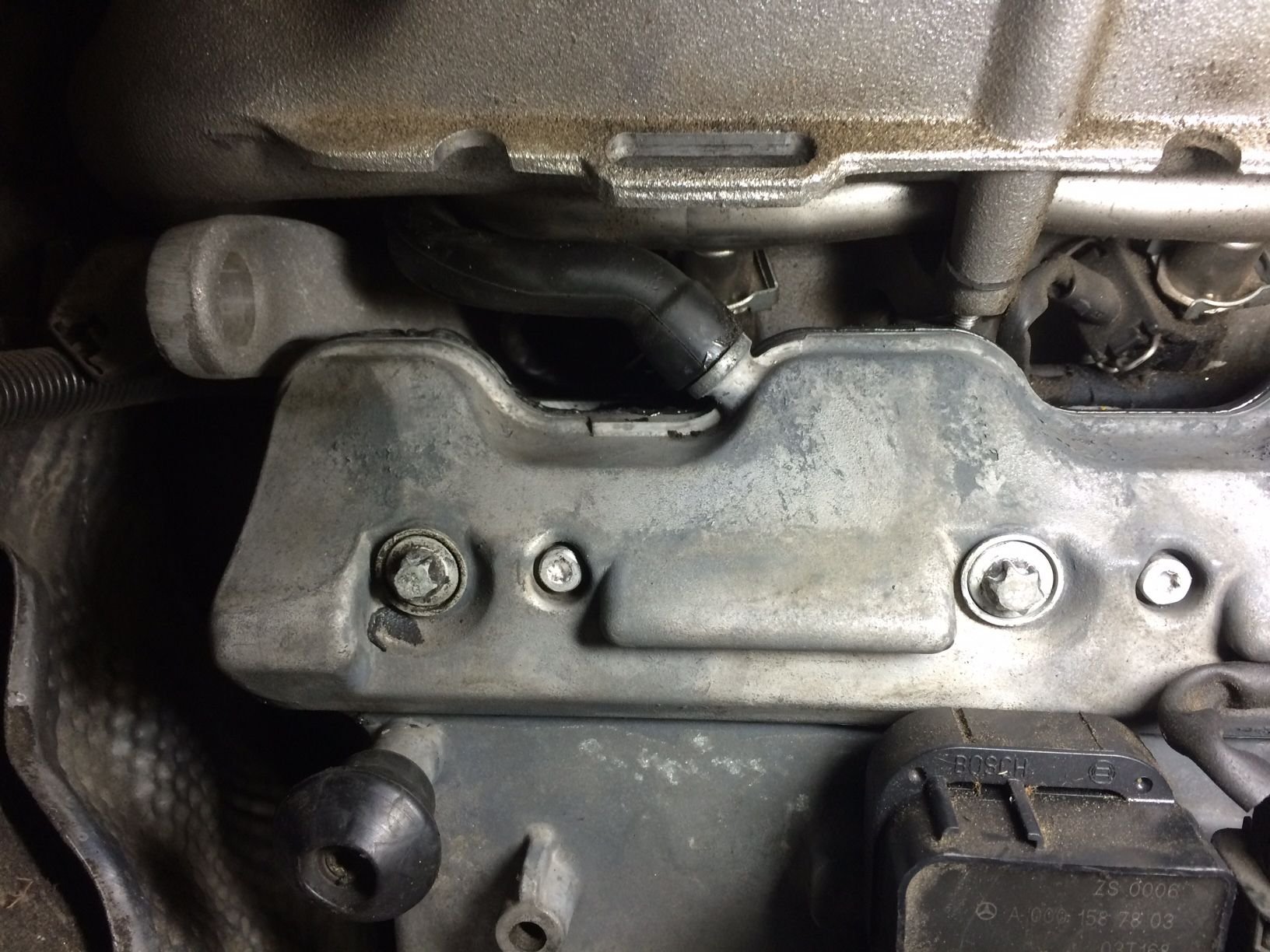

The passenger side breather hose underneath the box had a chuck taken out of it. I used a mirror and flashlight and looks to be at fault. Odd thing is, car ran fine before the valve cover gaskets were replaced. It almost looks like it was crimped.
So, it will run like crap until I can have the dealer fix it (in training all week and can't even get the part and do it myself). I could send the Mrs to the shop, but I rather not.

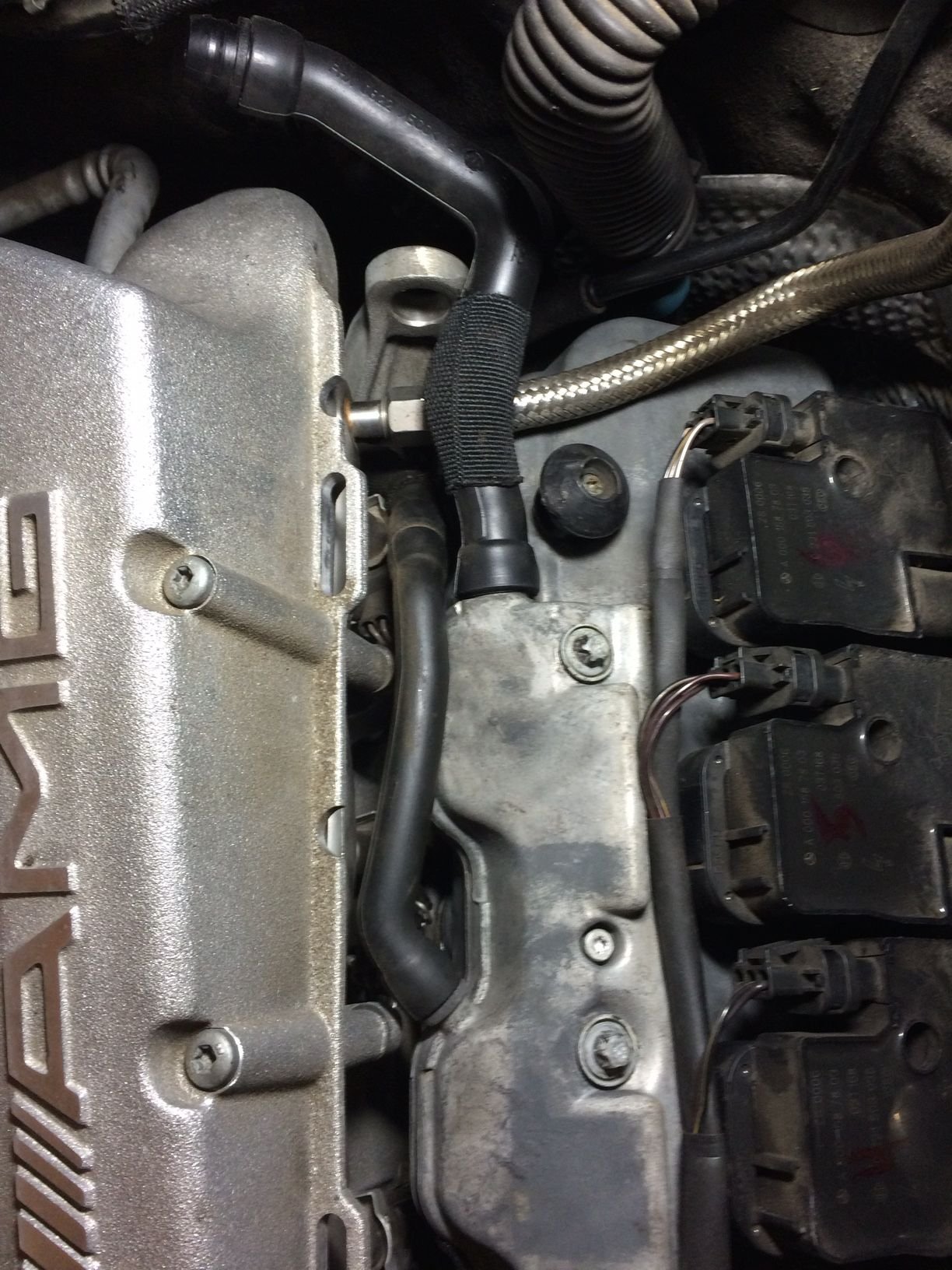

Did not see anything odd, but cleaned dirty throttle body, and code3 filter...
I also checked all the hoses and all is good. I will test drive this weekend. If I recall, the CEL comes on with the GAS CAP warning, and then low fuel after 30-minutes of driving..
