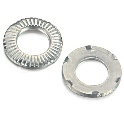

Looks good, if you can put contact washer, it will be more better..
