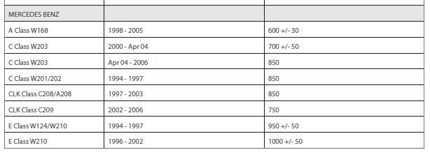

Take it to a shop, have them remove all refrigerant, check to ensure it holds vacuum, then charge with the amount of refrigerant shown in the attached screenshot. The measurements are in grams.
Attached Thumbnails Safe to add 12 ounces of freon without gauge?-quantity.jpg
