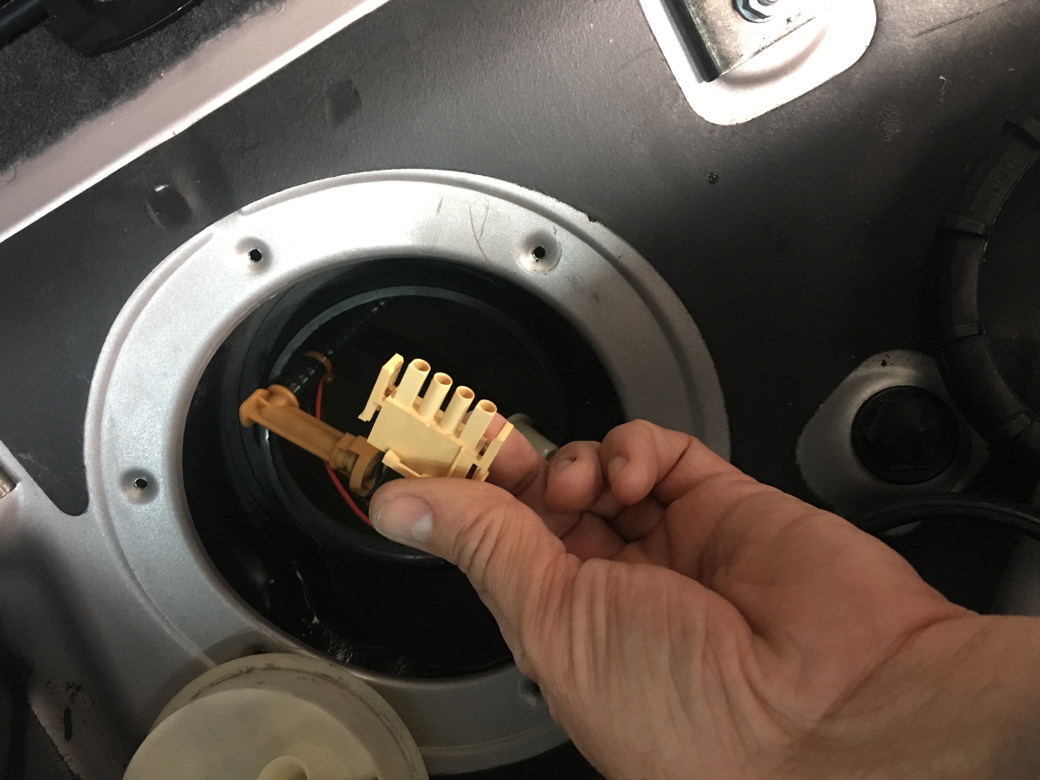

Connection
The one inside the tank is coming from the sending unit. I have voltage going to it. The other 1 on the main fuel pump that goes to the secondary pump doesn't show voltage. Unless I unhook the secondary smaller pump. Both pumps operate just fine hooked to the battery. After charging the battery everything is hitting almost 11 volts.
Attached Thumbnails fuel pressure issues-img_8297.jpg   fuel pressure issues-img_8298.jpg

ok guys bit of help here. I have our c32 running again. the aftermarket pump i ordered first didnt work as well as the sending units as they had a small square style plug on them let alone didnt have the double double pump system. i knew it was to good to be true. Mine did have the flat 4 plug pin going from the sending unit to the pump itself. so i ordered the nice $1500 dollar set, with sending unit that of course seems to be the same black square 4 wire plug not the flat 4 wire plug. i didnt pay much attention when installing but i did notice that the sending unit fuel level wiring is different on the unit itself compared to what i had originally. of course i tossed in the trash. does anyone happen to have a photo of a sending unit that might have the flat 4 pin harness i can use for reference to rewire this thing??

this is the plug i am looking at and the square style i changed over to
