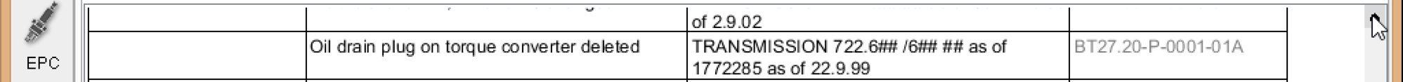

Pan filter magnet
EPC and WIS are contradictory. EPC shows the drain plug, WIS says it was deleted in Sept of 1999 for cost reasons. EPC shows active part number for magnet. WIS deletes reference to magnet specific to your VIN instructions, but does say it was added on ‘01. I do not have torque drain plug on my ‘05. I did dig thru my pics - and do have a magnet. My apologies for the confusion.
