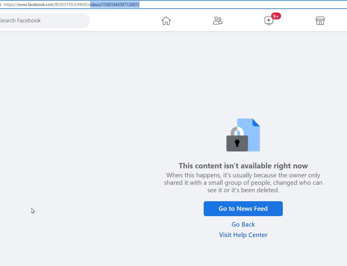

Oh by the way. I am not sure the facebook page is working right now. Here's a screenshot:
Ironically, google still thinks the page works.
