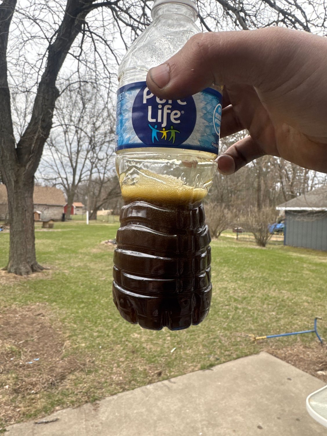

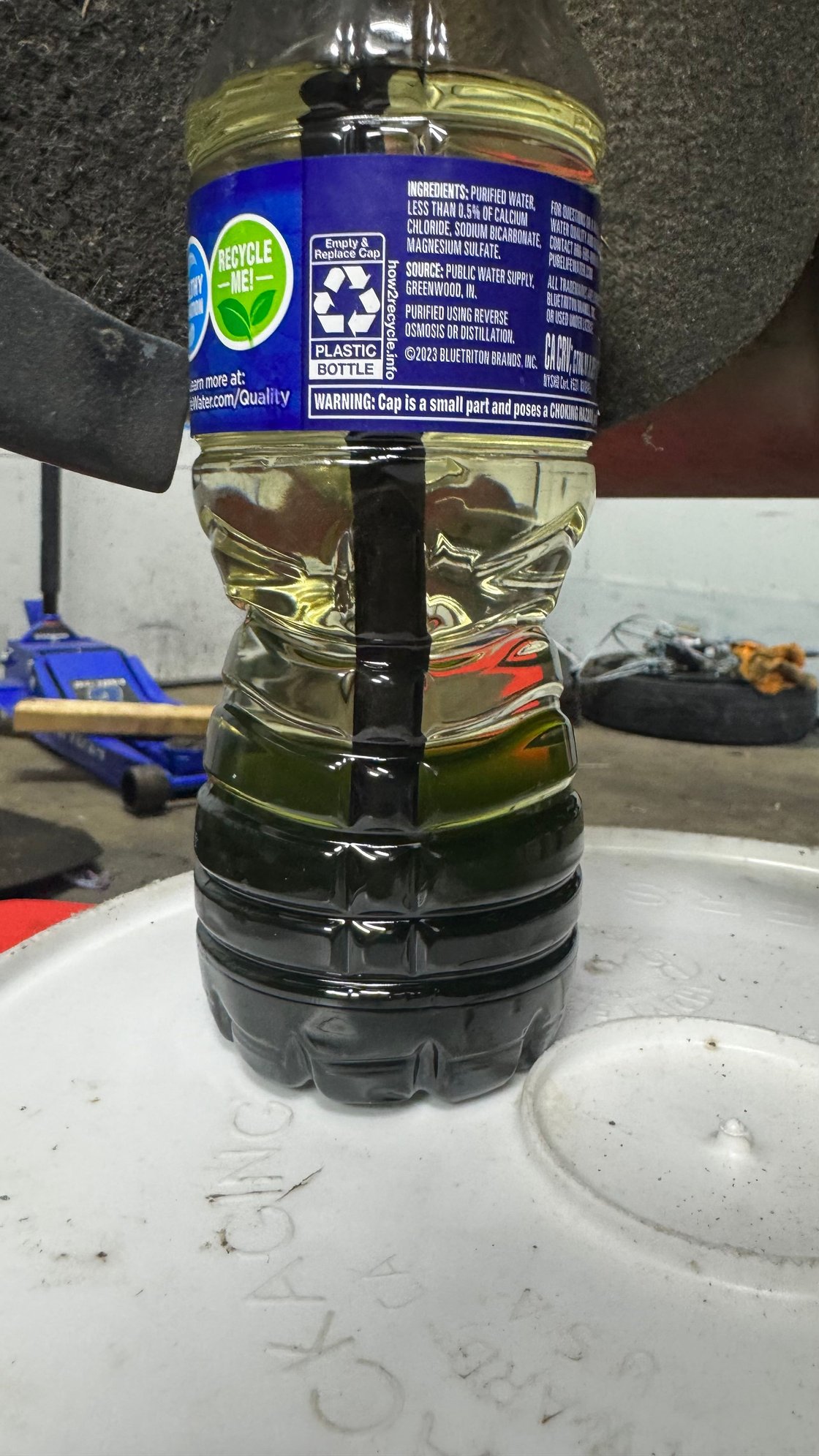

Here’s some pics of how the old fluid came out and the new PPE pan!
Brake fluid
Brake fluid
Power steering fluid

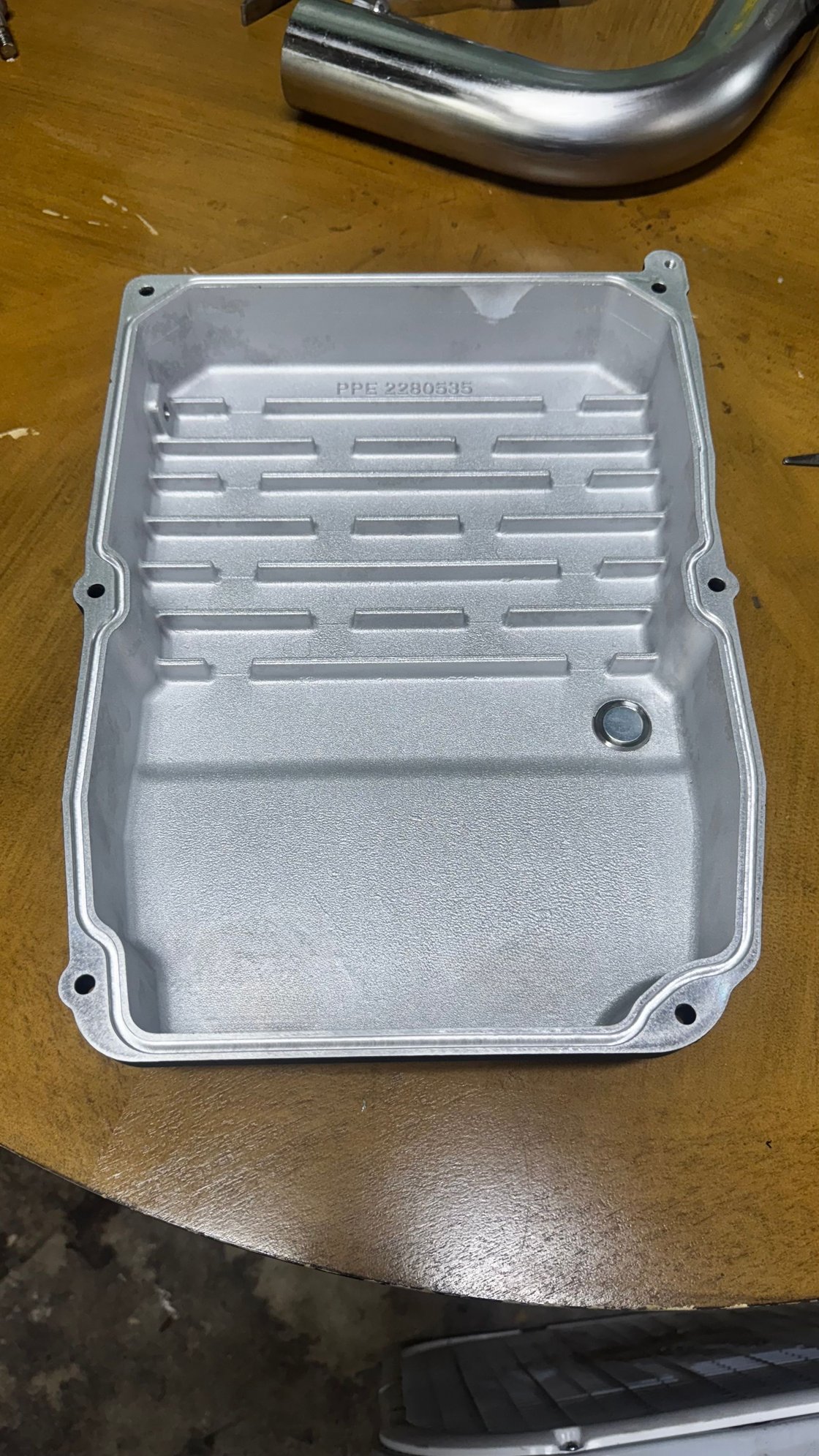

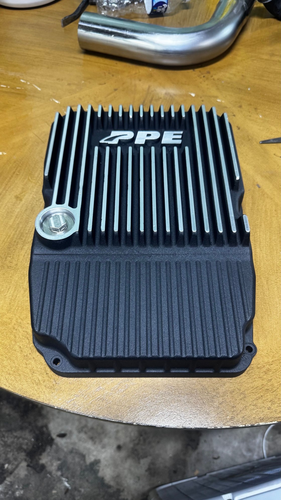

New PPE pan!
New PPE pan!
Inside of new PPE pan

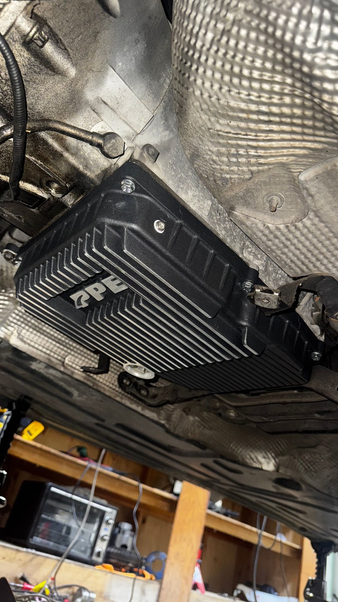

New PPE pan installed!
Great post! How do you check the fill level of the PPE pan if it's deeper to accommodate the extra fluid?
Reply 1
Mar 24, 2026 | 10:22 PM
  #31
Quote: Great post! How do you check the fill level of the PPE pan if it's deeper to accommodate the extra fluid?
The ppe pan has a raised point where the dipstick goes so that the dipstick will still measure correctly, i used to have a pic but sadly that was on my old phone, i have a 722.9 in the car now so the pan is long gone. It was really nice though, if they made one for the .9 id probably get it.
