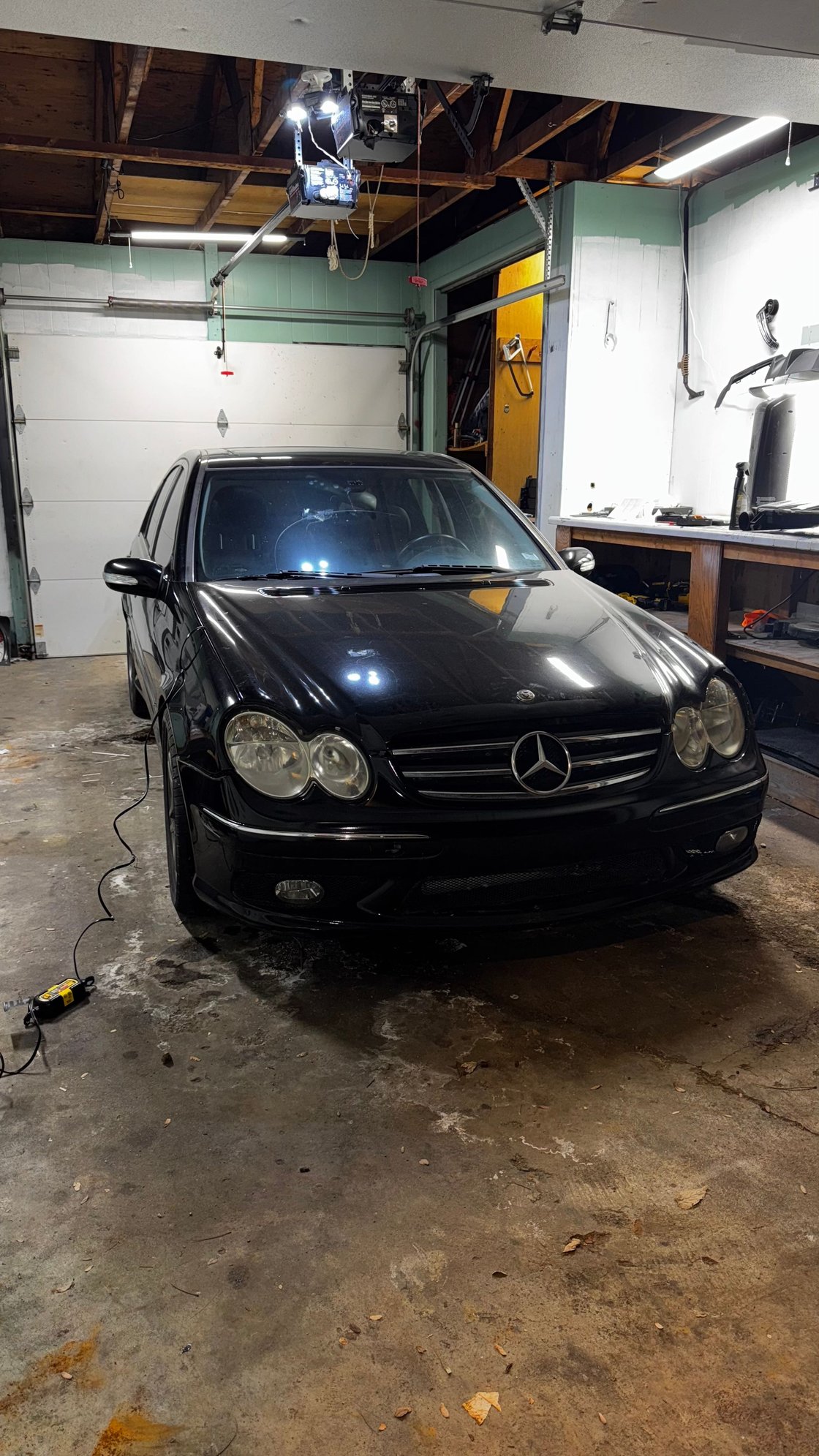

I was considering making a post here about this 2006 C55 AMG that I picked up to build and fix up, and a friend told me I should, so here we go!
This is my 2006 C55 AMG that I bought about a month ago for $2000 USD. I picked it up as a no crank, no start and figured if worst came to worst, I could part it out. I have wanted to own a C55 for a few years, and when I saw this one, I decided it was time.
I have a decent background in fixing automobiles since I grew up at my grandparents’ shop until I was about 19, always helping out and working there for a bit. So I decided to take on the challenge of fixing this thing up and giving it the second life it deserves.
So far, it has been amazing to work on. Everything is super simple and straightforward. When I got it home, the first thing I did was get under it and have a friend attempt to crank it while I tested the starter to see if it was getting power—and sure enough, it was! I bought a new starter and battery for it, along with new spark plugs, wires, and a crank position sensor, just to give it the best chance of starting. And sure enough, the thing fired right up like it had run 15 minutes earlier!
Since then, I have been doing a lot of maintenance and fixing small things that are not 100 percent on the car. I will be going through every single maintenance item to make sure it is completely sorted. The goal is to have a car that is still nice to drive on the street but can also head to the track or an autocross on the weekends and be pretty competitive.
Hopefully, you guys like the build and restoration. I for sure cannot wait until it is done!

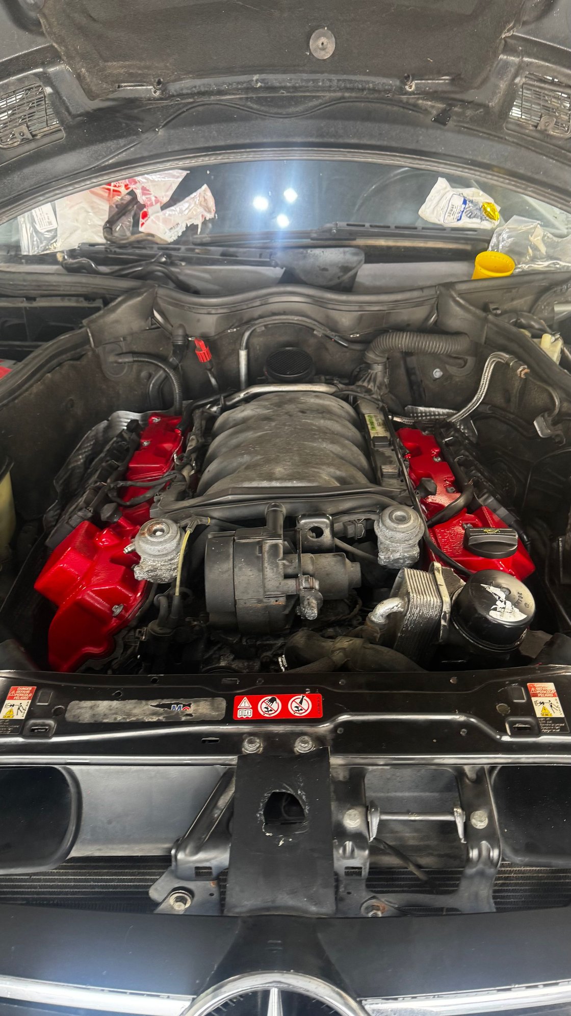

some more work.
So after hearing it run, I decided to tackle some of the common issues these cars have to make sure they do not come up later. I already mentioned the crankshaft position sensor, but I also did the valve cover gaskets, transmission connector plug, new connectors for the coil packs, and new crankcase breather hoses.
Stuff that did not necessarily need to be done, but I decided to do while the car was already apart, included installing headers, flushing and replacing the coolant, and installing a new negative battery cable since that broke on my last W203 and looked like it was going to happen again. I also painted the valve covers since I had them off and had plenty of paint and primer laying around (+5hp hahah).
I will make another reply showing pictures of the headers.
here’s what the engine looks like now!
yes, I know I know. Everybody does red, but I had it and looks better than before. Plus I always liked having cars with black as the main color and red accents. I’d like to do the intake manifold in wrinkle black whenever I have that off someday.

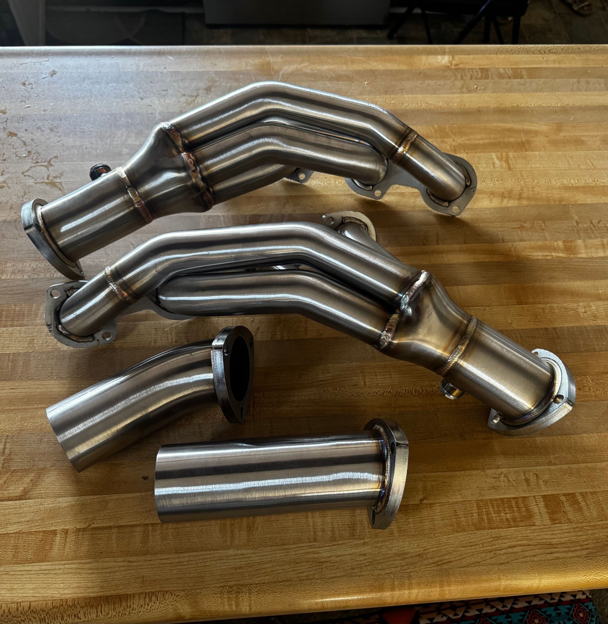

The headers!
So here are the headers. I was going to buy the VRP mid-lengths but was told they are just sourced from China, so I got them from the source for half the price! Picked these up for $420, and honestly, I am impressed. The metal is nice and thick, the welds are great, and any welds on the inside are smoothed out very nicely. I have gotten to see a lot of headers and systems during my time at the shop since we have installed many and always use them on our race cars and whatnot, so seeing the quality on these for the price was really shocking.
The extra plus? They fit perfectly! Install was super easy, and I had them on in no time. They look great on there too. I still have to take it down to the shop to connect the headers to the factory exhaust system, but that will be very easy.

That’s a good project, where did you get those headers? You may want to make sure the breather holes in the valve covers aren’t plugged, the hole is about 1 mm and prone to gunking up. I have found that most of the valve stem seals on these engines are toast as well and replaced them due to high oil consumption. The only other issue I have encountered is the front cover coolant orings that swell and in some they begin leaking coolant into the crankcase and may become dislodged and find their way into the passenger head. .
When I had the valve covers off to reseal them, I went through all the breather ports and passages to make sure nothing was gunked up like you mentioned. The stem seals on my C240 were shot—after idling for a bit or sitting for a few days, it would blow out a nice little cloud of smoke, haha. Hopefully, the ones in this engine are fine, but if not, it wouldn’t be the end of the world. The coolant O-rings worry me a bit more, but if they fail, it’ll just be another job to add to the list.

1) any CEL or anything with those headers? If not, please be so kind as to share that sauce/source!

Thank you! Unfortunately, I haven’t had a chance to drive the car yet, so there’s no check engine light (CEL) at the moment. I also cleared all stored faults using Xentry to start with a clean slate and see what actually needs attention. I’m still waiting on a few more parts, but once they arrive, the car will be back on the road.
As for the headers, they will definitely trigger a CEL since installing them removes the primary catalytic converters. The ECU will detect that the catalytic converters are “not functioning,” but any competent tuner should be able to disable the associated fault code when you get a tune, preventing the CEL from coming on.
To answer your other question, in terms of repairs, I’d say the most challenging job is the starter—though it’s still relatively straightforward. The real difficulty comes if you run into issues with the two bolts connecting the catalytic converters to the manifolds. If they are seized or snap, it can be a real hassle to remove them. I got lucky with mine, and they came out without trouble.
For modifications, the headers are probably the trickiest. As mentioned, those two bolts on the cat-to-manifold connection can be problematic. Additionally, the exhaust manifold studs themselves can be a challenge—if one breaks, it can turn into a tedious job. They’re fairly easy to access when everything comes apart smoothly, but if a stud strips or snaps, it can make the installation significantly more frustrating.
With any of the bolts I mentioned that could potentially break or be troublesome, I highly recommend soaking them a few times with a penetrating fluid a few days before you start working, if possible. If you can go without driving the vehicle for a few days, this will give the fluid time to work its way into the threads. If you don’t have that much time, at least spray them well and let them sit for a few hours before attempting to remove them.

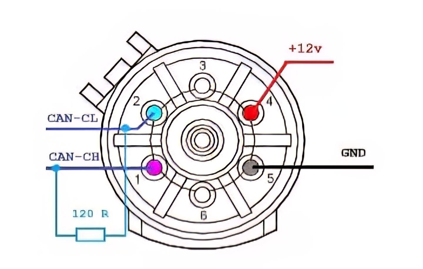

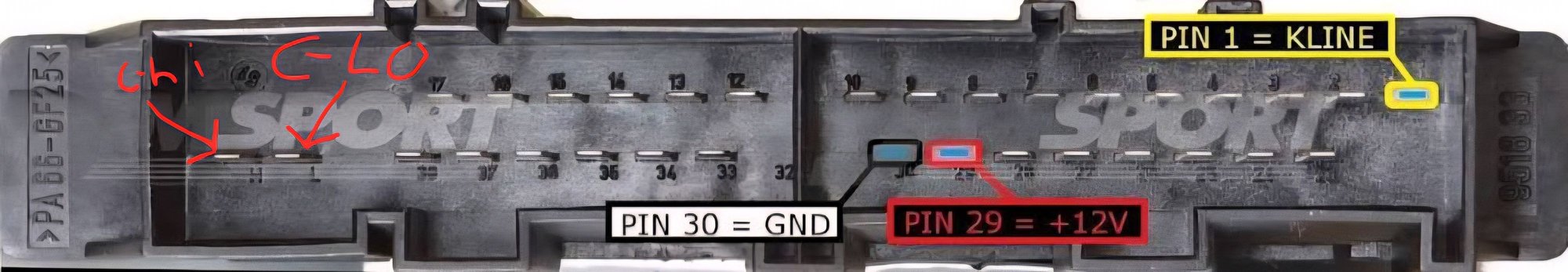

Originally Posted by PJmak
Please keep us posted on the 722.9 swap. I also want to do that in mine.
IS there a cable adapter available or do you need a separate harness?
So there is no custom harness for the 722.9 swap, but the wiring itself is actually the easiest part of this swap! I’ll add some pics below, but you completely cut the original EGS52 out of the system.The 722.9’s VGS system only uses 4 or 5 wires, depending on generation (VGS2 is 5, VGS3 is 4), and that’s exactly what the EGS52 uses — 5 wires. Meaning the wiring is as simple as cutting all of the old EGS52 wiring out, splicing in the VGS-style connector, and that is all!The wires are: +12V, ground, CAN high, CAN low, and K-line (K-line is only used on VGS2).
*fair warning, I HAVE NOT BEEN ABLE TO TEST YET, PLEASE DONT RECREATE UNTIL EVERYTHING IS 100 AND THE CAR IS ON THE ROAD*
