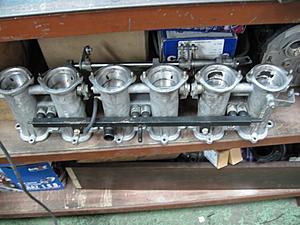

Now your talking!!! ...Cant wait to see itb's on that engine!
So the gearbox is indeed a petrol W203 box,I bought one last month with the hope it will bolt directly to the M113,the bell housings look very close...please share what changes you made ...was it just locating pins,or was there more?

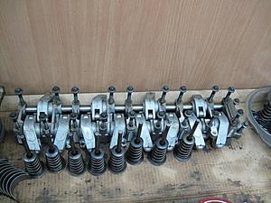

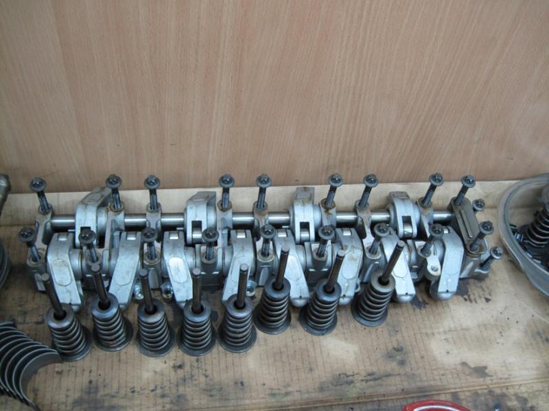

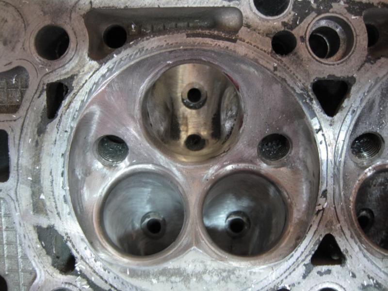

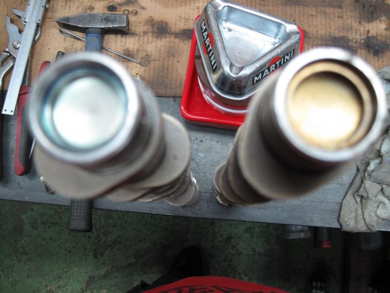

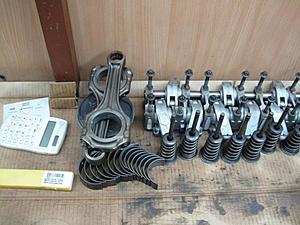

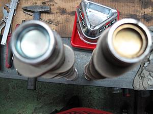

completelly forgot about custom camshafts and light flywheel))
Attached Thumbnails The new project-569.jpg   The new project-570.jpg   The new project-576.jpg   The new project-583.jpg   The new project-584.jpg

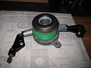

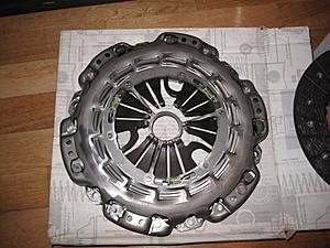

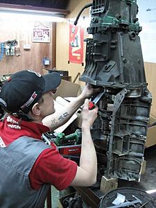

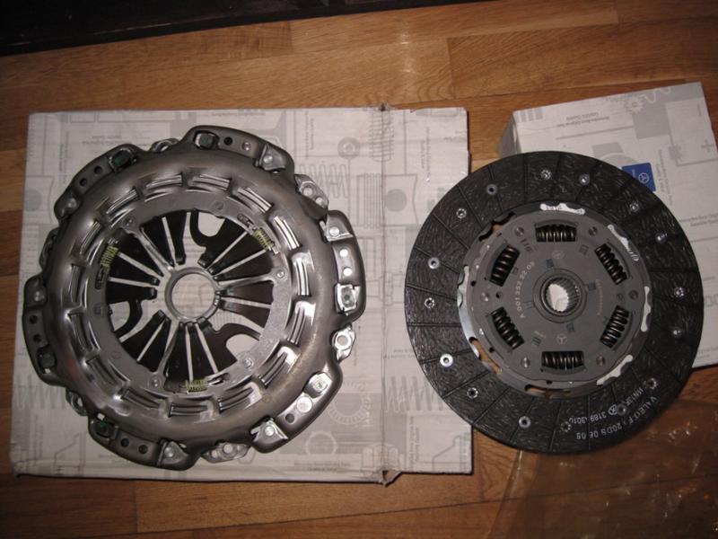

23K, the biggest problem we faced was the overall length of the drive shaft. It turned out to be half an inch shorter than we expected.. that's all I can tell you..) After we solved that porblem it became as easy as locating pins
check out ITBs and clutch vs release bearing!)
Attached Thumbnails The new project-574.jpg   The new project-553.jpg   The new project-554.jpg   The new project-556.jpg   The new project-557.jpg

I notice the clutch is sprung,Is the new flywheel single mass?...i thought mercedes ran dual mass on everything these days?
Old Apr 23, 2011 | 05:38 AM
  #183
hitch's Avatar
Joined: Mar 2009
Posts: 36
Mercedes-Benz W203 C230k
Oem flywheel is dual mass obviously, but we decided to make a lighter single mass version, because we're sticking to the racing ideology. Besides, the clutch is a w204 unit, which means that it is bigger in diameter and has different fitment.) In short, we decided that 203 petrol manual gearbox swap without adaptor plate is not much easier than 203 diesel gearbox swap with it.

I mean,I can see a mercedes symbol on the sprung clutch,which got me thinking you had a mercedes single mass flywheel as well!. look forward to seeing how you build the flywheel!.

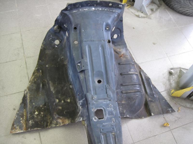

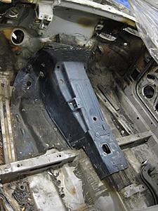

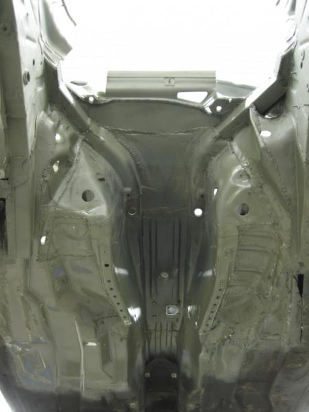

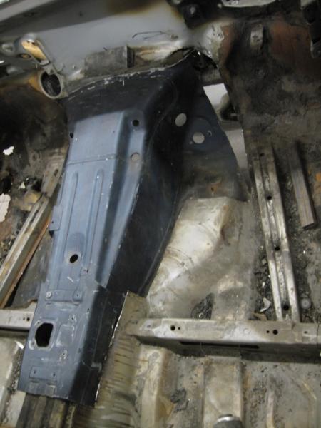

We found out that the two above mentioned gearboxes are almost identical. The difference is clutch unit and release bearing. If the diesel gearbox deals with 600Nm (must be around 500lb/ft) of torque, we think that the petrol gearbox must last at least 5-6 months. That's the term I can live with. Speaking about the tunnel, we've replaced the tunnel with the one from 210 E55, so don't worry
Attached Thumbnails The new project-456.jpg   The new project-457.jpg   The new project-459.jpg   The new project-539.jpg

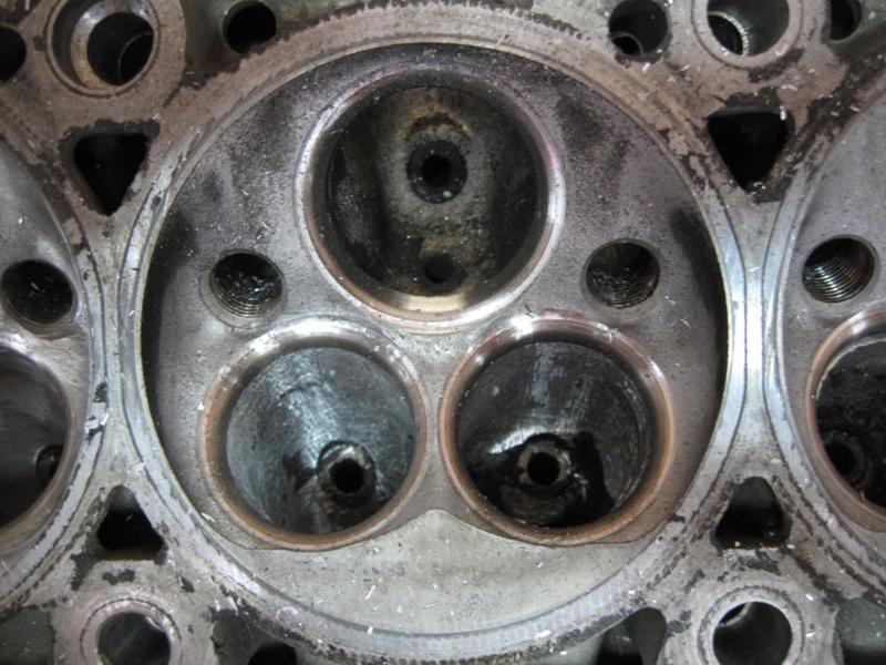

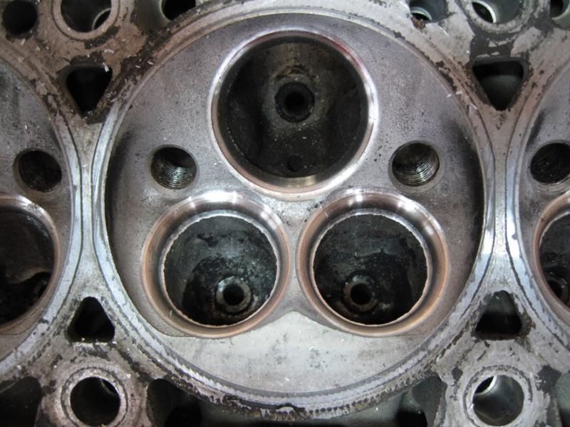

Hitch - with the head work you have done, did you do a flow test before and after? Curious to know if there were any real gains to be made in the combustion chamber.

siswati, I'm afraid we didn't. But I can assure you that there's a lot to be made. Our engineer has increased the channels by 4mm each and modified the geometry of air flow.
