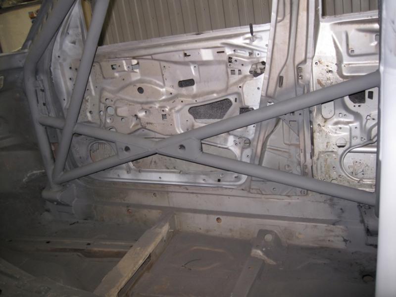

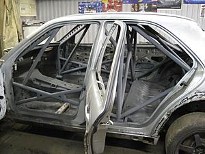

Well, since Alex is not entertaining you enough, let me comment the pics and try and answer your questions. We've done a rally spec rollcage to meet the fia regulations, because the car is going to take part in different events inside and outside Russia. So, at the moment the car is being resprayed. After that we'll do the wiring and begin assembling. The roof is mounted with the special glue, we borrowed from e92 m3 service manual, so we're quite sure, it will withstand everything. Speaking about the tranny, it is a petrol gearbox from w203 c240/320 with a diesel clutch and release bearing. Besides, we bought a very big rear diff and going to fit it with a quite lsd from c32. Finally, we cut unnecessary metal from the wheel arches and replaced it with light plastic covers. Thus, we solved the steering problem (wheels used to clip arches in full lock) and saved some weight. Cheers, guys! We'll keep the news coming.

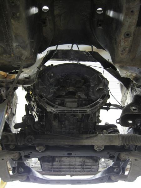

Did the manual transmission bolt up? It doesn't look like you have an adapter plate.

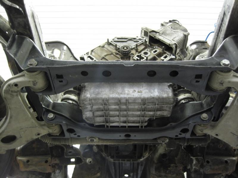

it didn't bolt up without any problems - the "bell" is slightly modified. Still the conclusion we can draw is that both petrol and diesel gearboxes can fit if needed.

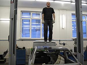

Besides, I want to mention that alongside the w210 subframes the car got the w210 amg steering rack instead of that old piece of **** whatever it is called. And our cf roof has already been tested by the leader of our team ( almost 200lb )
