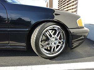

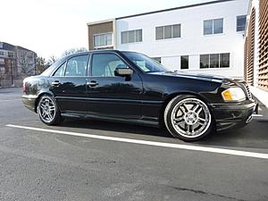

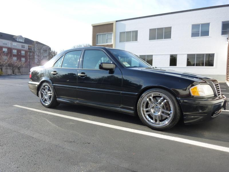

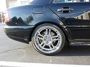

UPDATE: After way too many man hours, the new shocks, springs, tie rod end and ball joints are in (they forgot the steering damper ). Most of the bolts were frozen so they had to heat the bolts so that they expand and then take them out.
I'm getting my alignment tomorrow but I can already say that the car feels a thousand times tighter than before. The car is stiffer and jumps in the corners without a hint of body-roll. So much nicer to drive and much more enjoyable.
I love the way to car feels but it's real stiff, I took my friends for a ride and after 5 min they complained about their backs ! I will keep it that way for now because I only drive 20 miles top a day and I love how stiff the car is but in the future I might go back to stock Bilstein and not sport. The main issue are the roads here in mass which suck and are full of cracks and pot holes.
The car seats very low though, there is not even a finger gap between the tires and the wheel arches. It's a bit too low for me and I guess I will try to play with the spring pads to gain few mm if I can. I need to check which pads I'm running as of today.
Here are the long awaited pictures of the car with the new set up. What do you guys think ?

Looks nice, low but not too low. If people complain of back pains, tell them to drive a water bed or some other slush type vehicle

I agree, that's not too low at all. If it tucked all round, then that would be too low. Anyway, looks good, but you might want to space out those rear wheels just a tad (~5-8 mm?), and you're golden!~

So you got the H&R sport springs as opposed to the 'super sports' springs? Do you know what thickness pads you have?
Looks lile a great setup, but still high for my tastes :P

looks like stock euro spring factory height

@eek: No I don't run the H&R supersports. I ran H&R sports and Bilstein sports. This car is my daily driver, it's already stiff enough with my current setup. The car dropped even more since I got the alignment and drove it a little bit.
I don't know what kind of spring pads I'm running, I need to check it out soon. I'm driving to Montreal for Thanksgiving so that will be a nice trip to break in the new suspension. I'll check the spring pads when I come back since I want to raise the rear a little bit. The rear tires are now within the wheel arches. Ultimately I'm looking for 1 finger gap between tire and wheel arches.
I'll ask my mechanic about camber bolts. Next Saturday, I'm getting the entire underneath of the car painted with a special rubber-like paint that will protect the frame from rust, snow, salt, etc. I will have the entire new suspension checked and the rear raised a little bit.
I think the thickest pads you can buy for our car are #5 and #4 for the front and rear.

this is correct. I am running the #5 in the front and #4 in the rear and I am LOW. I believe the drop specs the manufacturer claims are based off of the euro spec spring as the vogtlands I have claimed a 1.4" drop and even with the largest spring pad I still got about 1.4" drop (maybe a little more)
As far as the camber bolts I wouldn't recommend going with the factory eccentrics as they don;t offer much adjustment. You might be able to get away with it but I doubt it if you are lower than 1.4". Get some K-MACs, they are GREAT!
The factory eccentric bolts are like $20 from the dealer, the K-MAC are closer to $400 with shipping
