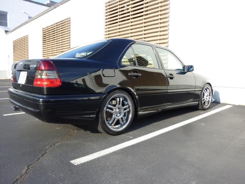

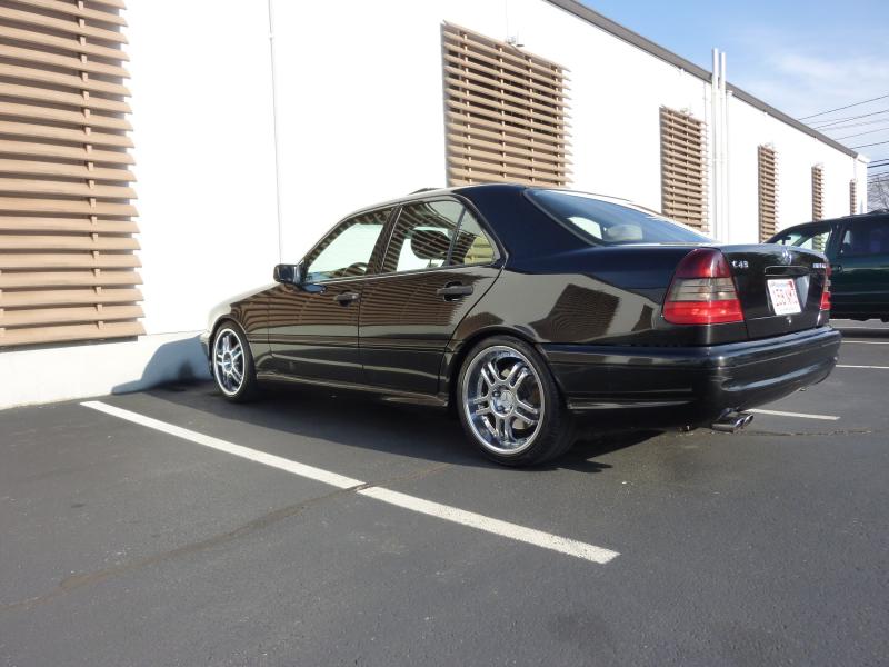

UPDATE: After way too many man hours, the new shocks, springs, tie rod end and ball joints are in (they forgot the steering damper ). Most of the bolts were frozen so they had to heat the bolts so that they expand and then take them out.
I'm getting my alignment tomorrow but I can already say that the car feels a thousand times tighter than before. The car is stiffer and jumps in the corners without a hint of body-roll. So much nicer to drive and much more enjoyable.
I love the way to car feels but it's real stiff, I took my friends for a ride and after 5 min they complained about their backs ! I will keep it that way for now because I only drive 20 miles top a day and I love how stiff the car is but in the future I might go back to stock Bilstein and not sport. The main issue are the roads here in mass which suck and are full of cracks and pot holes.
The car seats very low though, there is not even a finger gap between the tires and the wheel arches. It's a bit too low for me and I guess I will try to play with the spring pads to gain few mm if I can. I need to check which pads I'm running as of today.
Here are the long awaited pictures of the car with the new set up. What do you guys think ?
