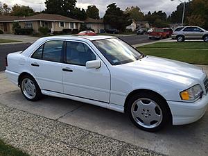

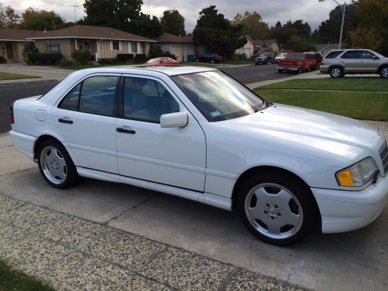

Just picked up a '98 white c43 and I love it, minus the repairs I gotta do right away. To cut to the chase, I am going to put Bilstein Sports + Vogtlands and was wondering if people can share pics of that setup with stock pads. I want to give my mechanic the right pads to put in from the get-go so I don't have to swap pads out later. I did a search, but couldn't find the specifics a lot of times. If you are running Bilstein Sports + Vogtlands, I'd appreciate a pic and the pads you are running.
I am rolling on stock 17" monos.
Thanks, and excited to start my 202 fun.
