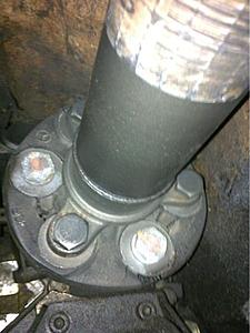

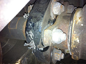

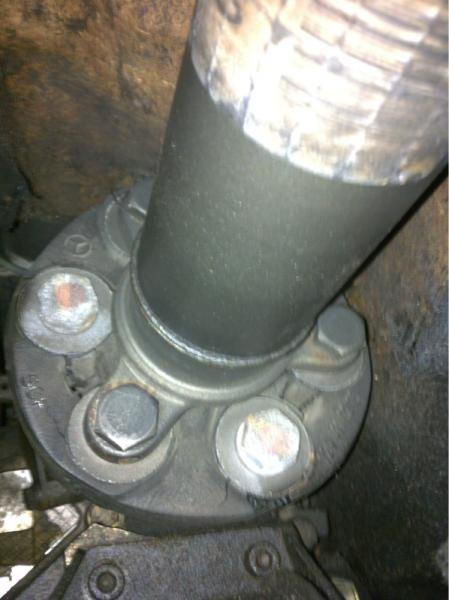

Originally Posted by Sulaco
Yes, one at each end of the driveshaft. If one of them has failed, then there's a very high probability that the other one is close to failure as well. They are rubber, and have a limited life span. Replace them both!

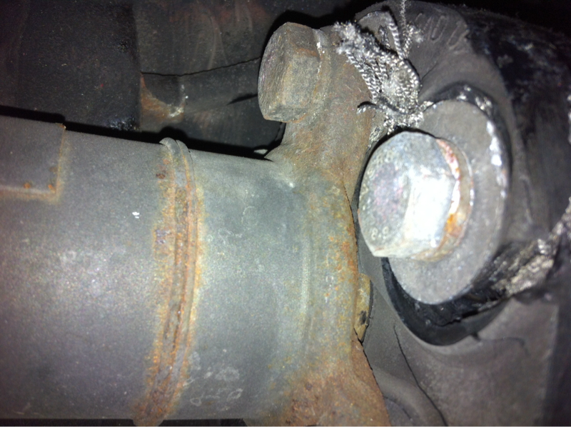

Ahh yessir, the weather was fair today and I had a chance to get under the AMG and inspect things and yes BOTH flex disc are bad with the rear being worst!!!!
Pics:
Front not so bad
Rear is terrible explains the squeaking noise as the deformed flex disc is rubbing the chassis.

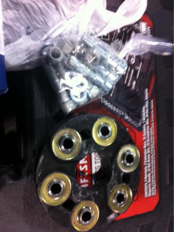

Flex disc is on order.

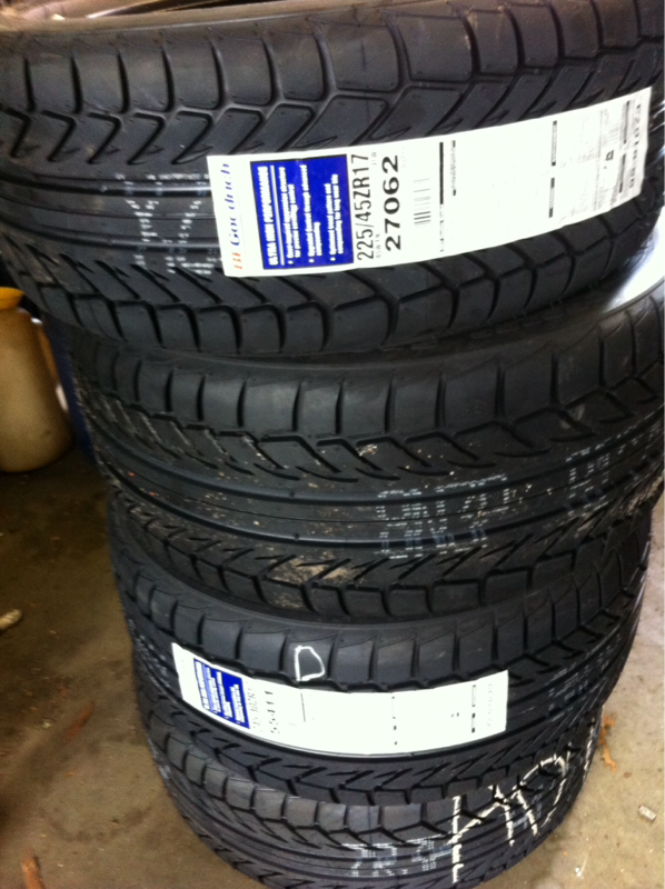

My tires came yesterday and my front flex disc so waiting on the rear now!

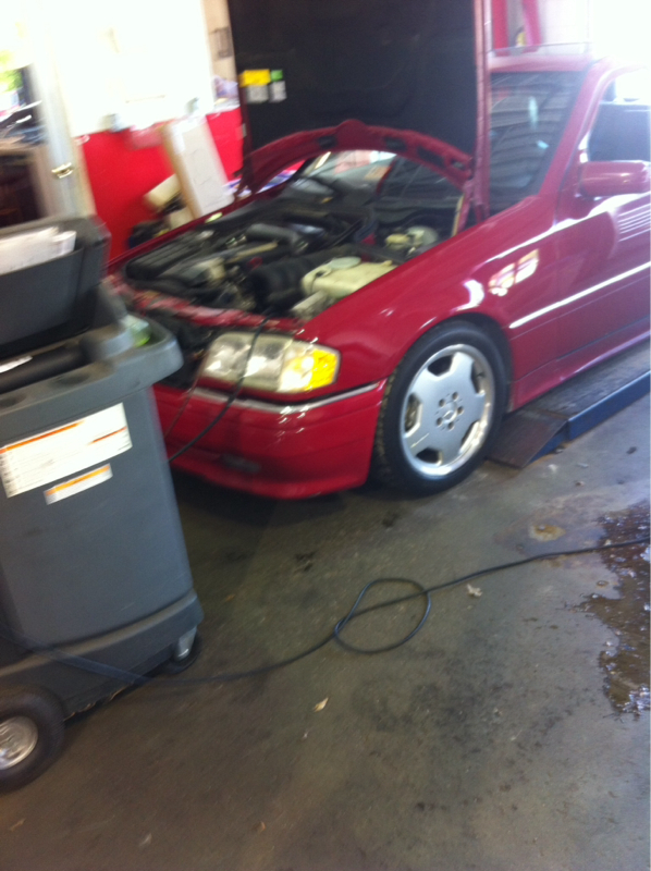

Got the flex disc disc replaced and front tie rods and steering damper new tires and alignment so we are rolling again and ac leak down test, evacuation and a recharge.

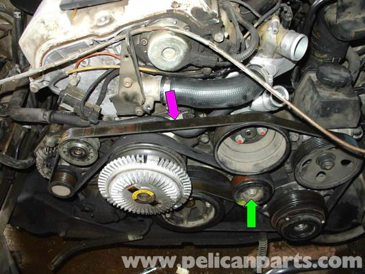

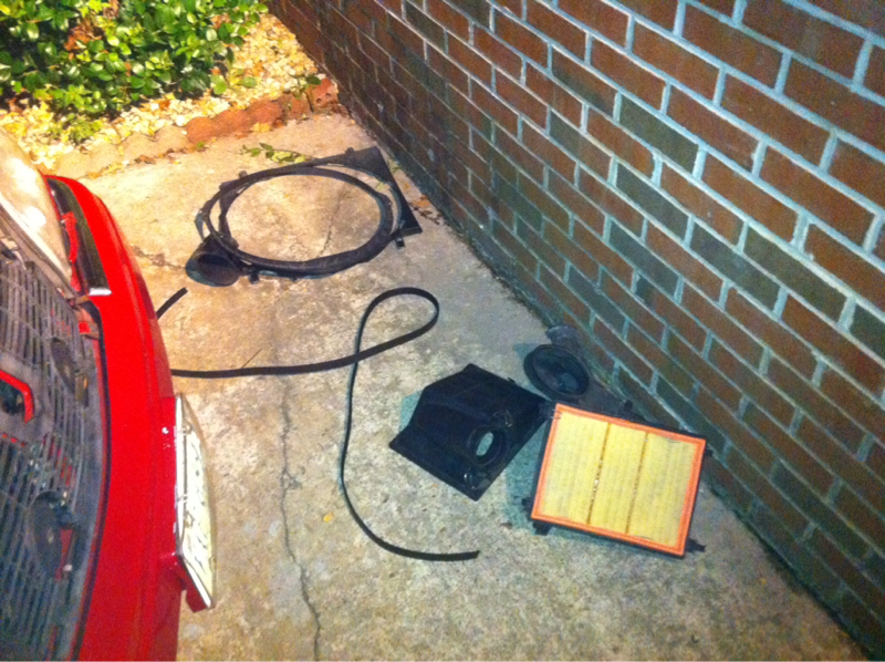

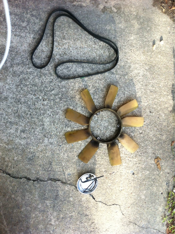

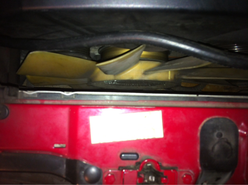

The tensioner is awesome getting the fan shroud out is a pain but not too hard. 15mm on the tensioner.
Get the fan out first is easier, I cutt the old belt off. 5 or 5.5 Allen for the fan bolts I think

I found the tensioner and if anyone needs help with this pm me.

Old Aug 11, 2014 | 11:34 PM
  #48
Twichel04's Avatar
Joined: Jul 2014
Posts: 214
From: Ocala, Fl
1996 C36 AMG and 1999 BMW e46
You shouldn't need to pull the fan to get to the belt tensioner, just rotate the fan till there is a gap in the blades. I didn't even had to pull the fan to swap out the belt. It's a bit of a pain to get it on the crank pulley that way, but it was better than removing the fan, lol. I love the red on the C36 by the way, definitely one of the better colors on these cars.
Old Aug 12, 2014 | 12:21 AM
  #49
Somalia757's Avatar
Joined: Nov 2013
Posts: 172
From: Virginia Beach
1995 AMG C36
Yea that gap is tiny, I got it loose via the tensioner but couldn't get it off the last pully because of the small gap ... haha thats why I cut he old belt off and called it a night. Fan is still on tomorrow after work I'm putting the new belt on. Thanks for the feedback
