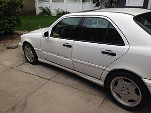

Cleared came out good, I'll give it a few days to harden good then I'll wet sand and buff it out

nice job!

Yeah looks really nice. Hard to say if the c43 will ever become collectible classic but it's always good to see old rides that are fixed up real nice regardless of the brand or model.

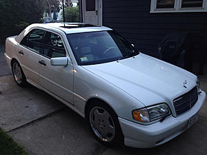

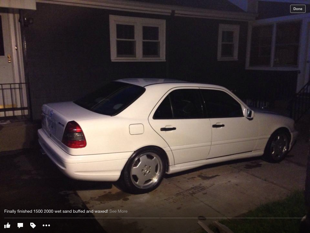

Decided to clay the rest of the car to get off the overspray then hit it with some polish and wax, not bad for 16yrs old!

Excellent job, you give it new live maaaaaaan..
now she should return a favor..

collectible classic or not, these cars will always be special. you know you love it when once-in-a-blue-moon someone who knows cars spots your w202 AMG and knows what it is.
great job on the paint, man. really brought that car back to life. and the white C43 look makes me light headed. beautiful!

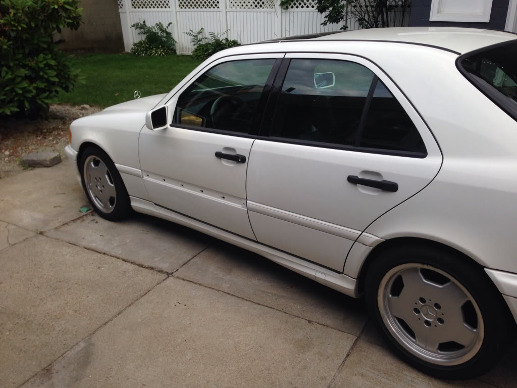

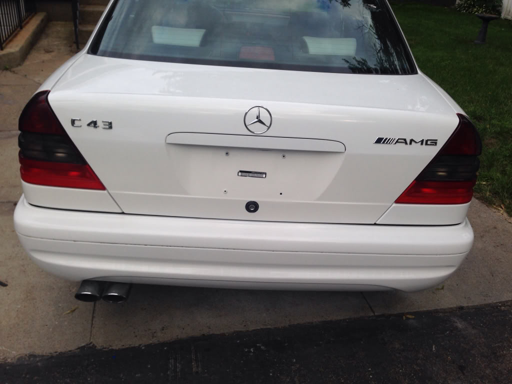

The final result wet sanded with 1500 and 2000 then some menzerna super intensive polish and some zymol!
