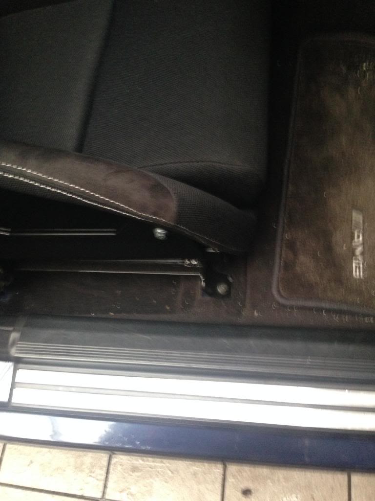

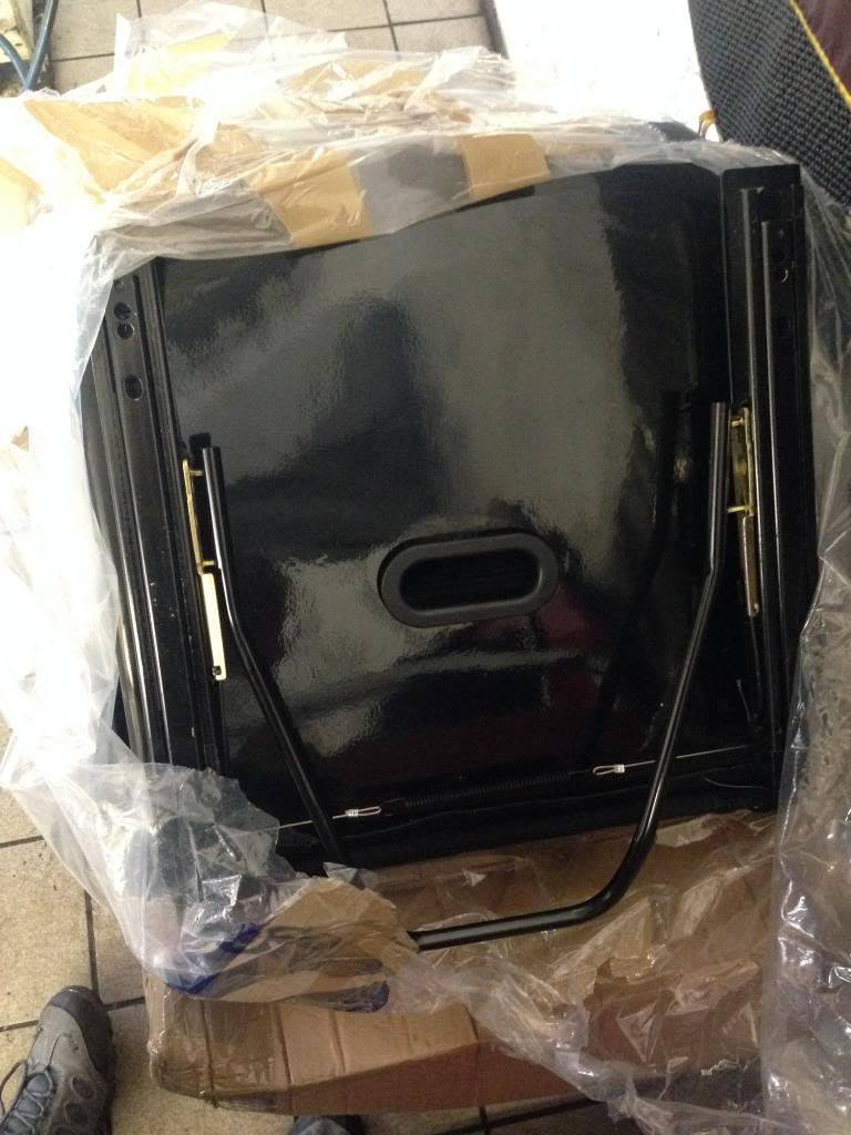

A bucket was on my mind for a while now so why not seeing as I plan more track days it made sense.

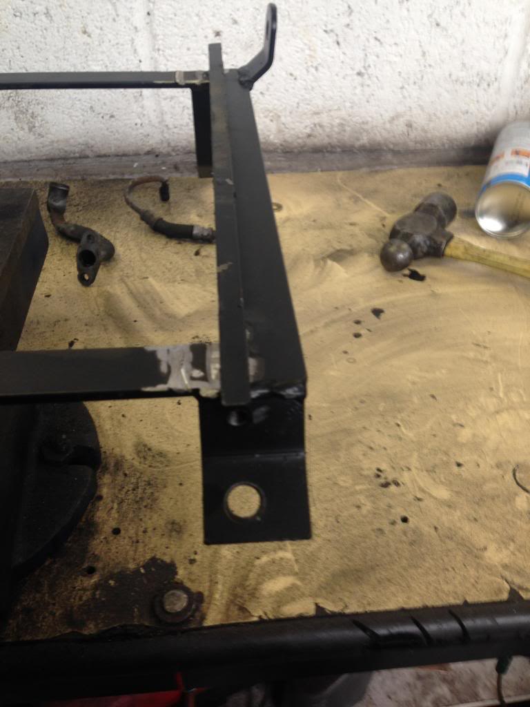

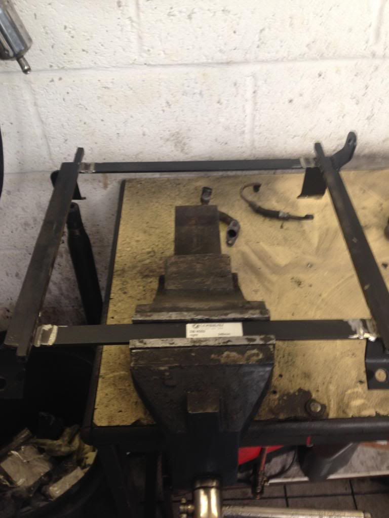

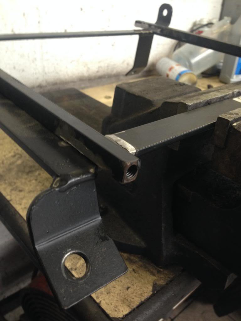

I had to fabricate the bracket a bit to make it wider so I could accept the seat sliders

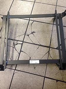

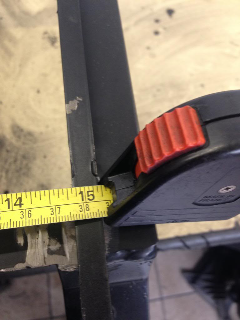

I had the make the bracket 380mm instead of 345mm

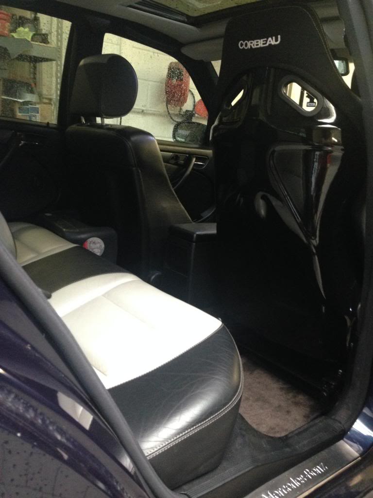

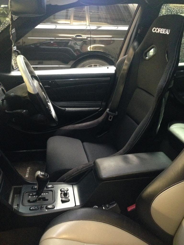

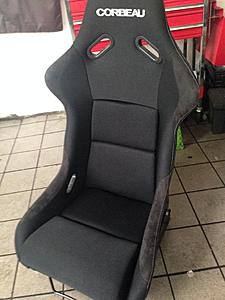

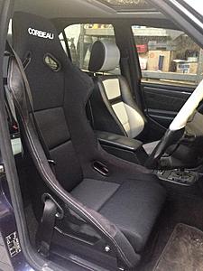

with a little swearing and adjustment it in the car
W202 Corbeau seat install-w202seat002_zpsb5f2c55f.jpgW202 Corbeau seat install-w202seat003_zps45c51c71.jpg
W202 Corbeau seat install-w202seat005_zps69d4fcbd.jpgW202 Corbeau seat install-w202seat004_zps3a24050d.jpg
