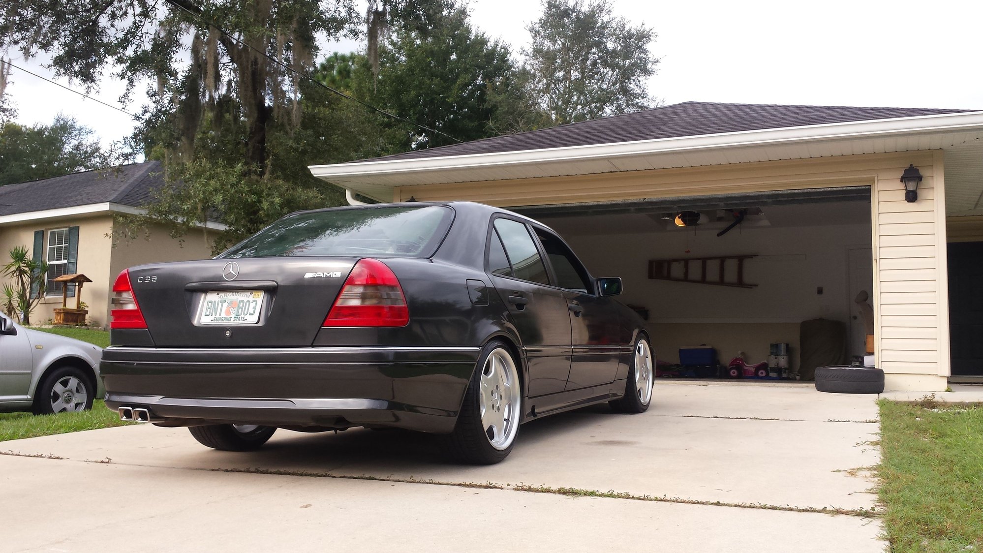

A couple shots from the other morning... I'm in love with this car with the new wheels and ride height...

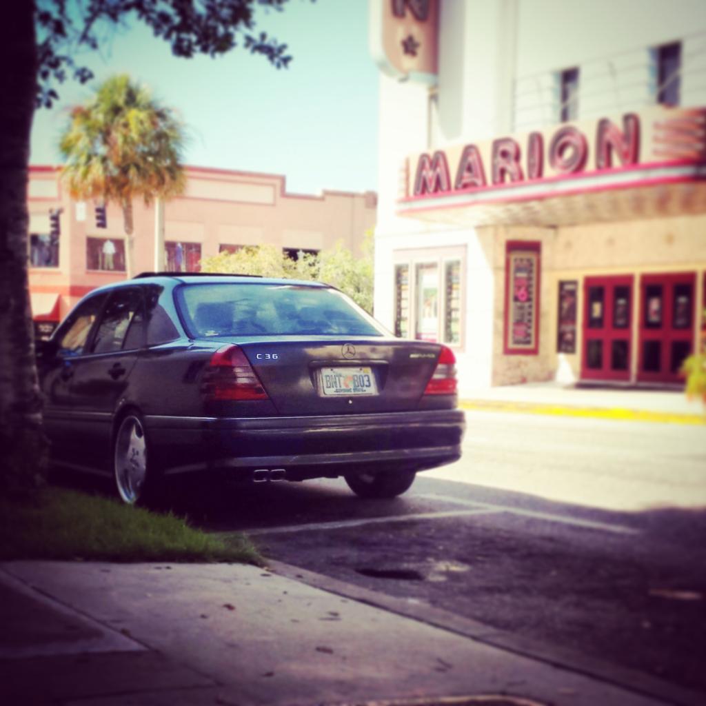

And lastly, an obligatory instagram picture that I thought was cool. I'm in love with these wheels, lol
