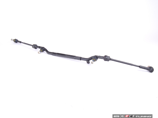

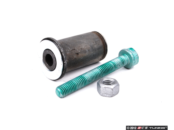

+1 with Dennis,
Also steering idler bush or drag link alignment, could do that..!

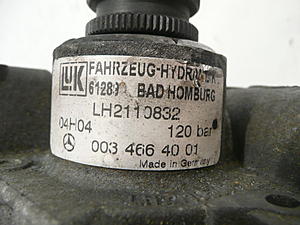

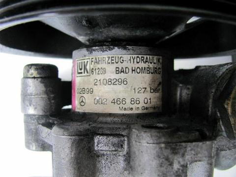

Aside note:
our steering pump is 115 bar, some of late models W203/W209/W163/W211/W463, uses 120 bar & 127 bar,,
better to go with newer's isn't..!-?-!
steering wobbles on uneven pavement-sp-120-bar.jpg & steering wobbles on uneven pavement-sp-127-bar.jpg
ZAYED,,
