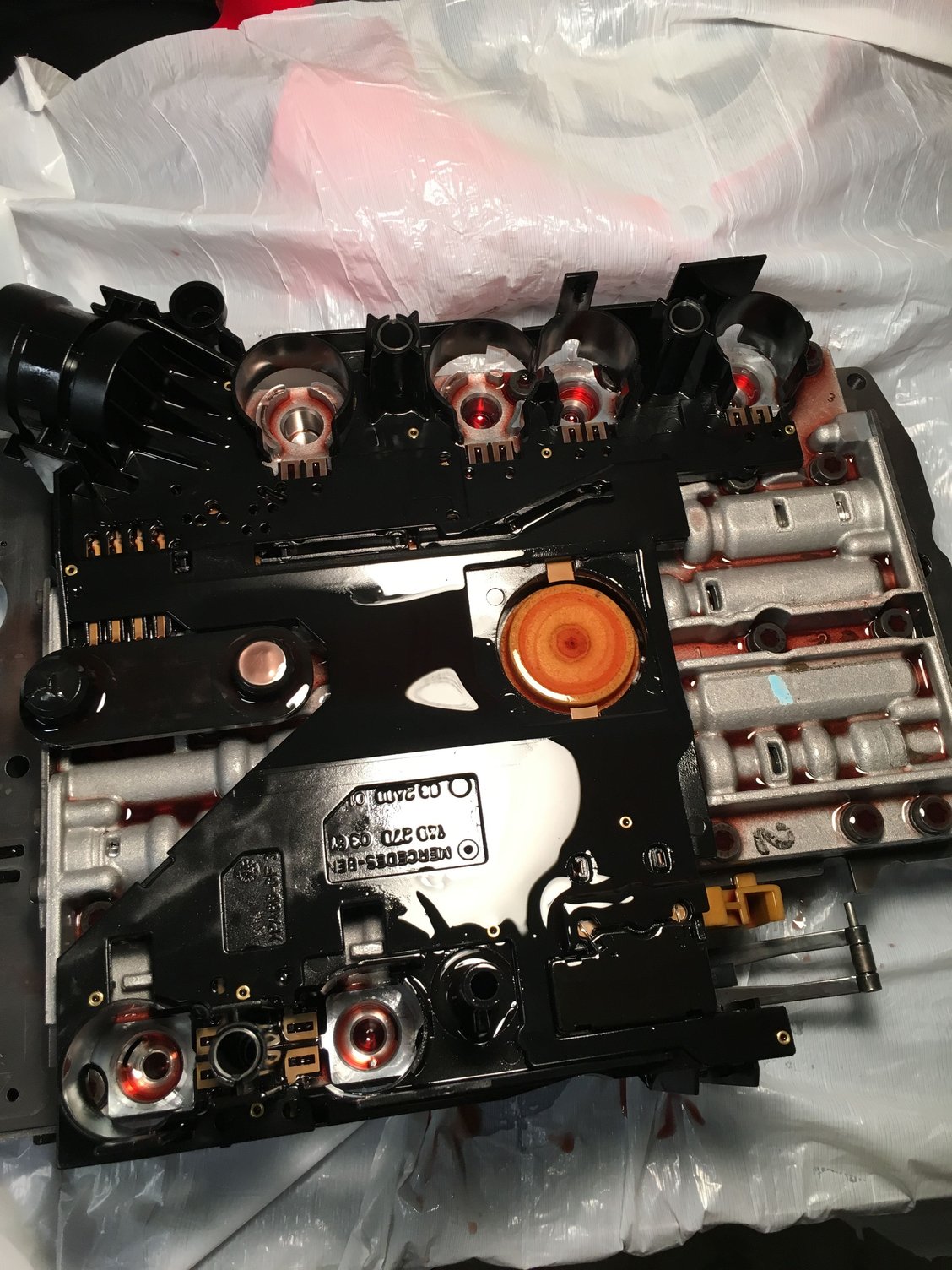

Sooo update on this if anyone gives a crap. For the 97 cars you can't used the obd2 port for star. You have to plug the multiplexer into the round port on the ECU/TCU box with the round locking cable to get it to work..
After figuring that out I dug into the codes and sure enough it was the speed sensor giving the fault. So down she comes. The job over all is pretty straight forward and there is an excellent video on you tube showing you how to do this. As you can see from the pictures the front speed sensor had cracked open in multiple spots and transmission clutch/plate deposits had made their home there..
Plate in and oil fill with max life atf (I know I'm probably going to get bombed for that but it does meet the MB spec for the nag 1 transmissions so figured I'd give it a try) car drives and shifts great. Might be in my head but seems like a shifts faster than before.
244k miles and climbing....
Cracked sensor
