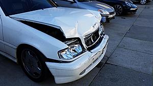

The car is in great condition otherwise. The interior is very very nice and all of the dents all around the car were fixed by me when I got it. Original transmission was rebuilt and runs great.
I posted on a couple of places on the internet and I already got people asking me about it, what is a good price to sell it at?
UPDATE: I just received an offer for it for $2,000. This is a guy from a salvage yard who knows someone who wants it up in Redding CA.
Does that sound like a good price? Anyone else want to look into it?

Why not sell it for that much? I am not able to fix it myself and I was told that it is too expensive to fix. What else would you suggest?

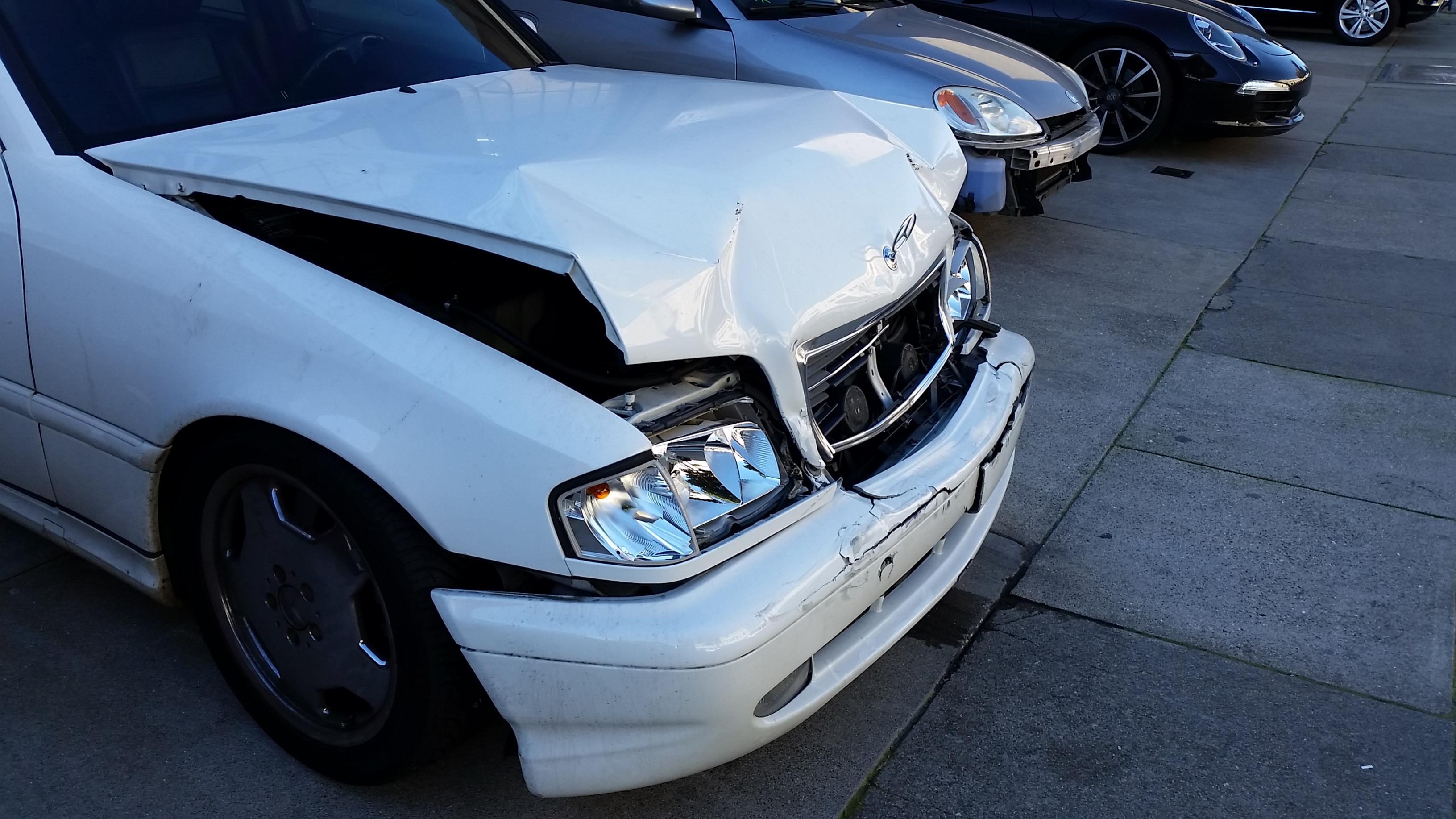

picture shows damage on front bumper, hood, headlights and grille, can you get these for cheap at junkyard, there are lots of white color w202's in USA?

The damage to your car looks very minimal, meaning that you can fix it yourself if you are willing to have a little patience and put a little elbow grease into it. If you aren't willing to put in the time or effort then yeah let it go for whatever, but I'll tell you now that is the wrong decision to make.
Your car needs a new hood, lights, and bumper, you can source these parts out on ebay or at a local salvage yard for less than $1000 and labor wont cost you a dime if you do it yourself. You can buy all the tools you need to replace those parts for less than $100. Afterwards, you can have it sprayed to match for as little as $150-$300.
If your car won't start, it's probably a minor mechanical issue that you can sort out yourself or get a shop to fix for $500 or less.
I'm guessing it will be less than $2000 to fix your car and if you add $2000 repair with $2000 sale, you only get $4000, which is less than what your car is worth. So keep it if you like your car, if you don't like your car, then I suggest you fix it anyway and sell it for closer to 5500-6000, still netting you a few thousand over the $2000 price the junker is looking to give you.

Yep fix it man. Hood is less than 200. Headlights can be bought for 100-200 for both and you can get a bumper for like 150 off a regular c class for now. White is a common color too so it should be easy to find. To replace all those parts you wont need more then a few hand tools that you already have. If you were local id seriously come and help you. Ive replaced parts lime that on w202s a lot and its pretty simple
Your car can look normal and in one peace in no time.

Ya those are chrome 18s. I bought the car lowered, I don't think it has special suspension, I think it was cut down or something. There's about 132,000 on the odometer.Originally Posted by mickey13

That is not much damage at all. if you want new, genuine parts, genuinemercedesparts.com is the cheapest. I purchased a brand new nose clip from Germany through them and it was only $762 USD. The hood can be from any W202 model as well as the grille. Don't let it go to a poacher from a salvage yard. He will fetch $1500-$2K for just the engine. The airbox along with engine cover sells for $400 alone from a salvage yard and can be purchased new for less at the website I listed. Good Luck!
I have the bumper support bar if you need it. It is the part that the bumper attaches to. You are free to have it if you want to pay the shipping. I can ship it out from Washington.

The damage looks very similar. I was able to get mine back on the road for very little. The difficulty in your case will be locating a C43 bumper. Good Luck.

This is the same exact damage I had on mine. Dealership quote for full repair: ~$11.8k. I got it done by sourcing my own parts and having a body shop do it for ~$6.8k.

The only part that you'll have trouble replacing is the front bumper. The rest of that is SUPER cheap and readily available.
My god, if I had the parts I could have that thing completely fixed in 6 hours, and I don't even have a shop to work in.

In my case I had my stock C280 bumpers but I did get the car back on the road for under $1000. To be fair I still have to have the hood painted (trying to decide if I should put the C36 stuff back which would require more painting).Originally Posted by mbsickness

I purchased everything used except for a headlight lens which was a dealer only item (xenon lens). Replaced parts are as follows
-Center radiator suport (section with the hood latch)
-Hood
-Grill
-Fan clutch
-Fan clutch bearing bracket
-serpentine belt
-belt idler
-radiator
-power steering oil cooler
-AC o-ring at the condenser
-AC recharge
It took about two weeks to do the work as I was waiting for parts as I also changed the waterpump while I had everything apart.
