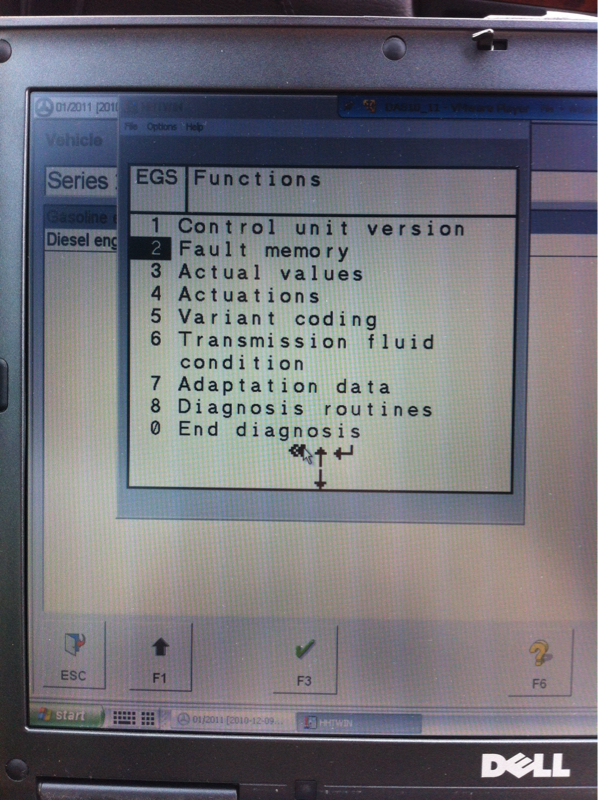

did you ever try this? I was poking around with the laptop the other day and got thinking about you question. The adaption data is in the EGS as you can see which I'm pretty sure is TCU only but not 100%. that's why it's an interesting idea to try and see what happens. I'm wondering if there is just a way to edit the variant coding and lock the adaption values to a set correction.
Going pretty far down the rabbit hole but I know different variant codes have been written for manual swapped cars to have the TCU stop looking for a auto transmission so it seems maybe possible but your going to have to dig to find the right guy to do it for you.

I haven't had much of a chance to do much this past month. I was hoping benzslo would have some insight on the possibility of this. Is that screen pulled up for a c36 or c43 though? A couple years ago when I was trying to see if I could swap a manual into my c43, I couldn't find anyone who has done it. Only found a c36 or two.

Yeah this was pulled up on a 97 c36 with the 722.629.
