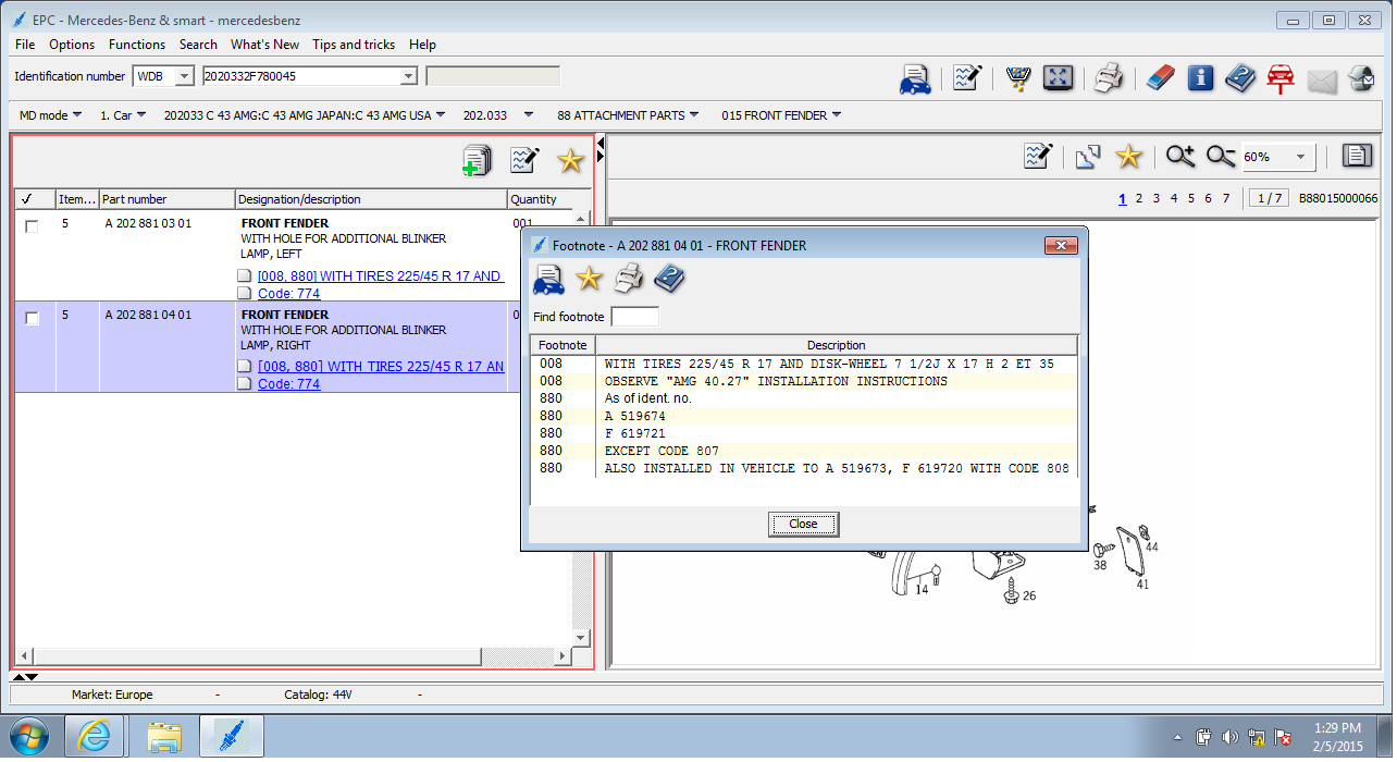

*in EPC & MB/W202 factory data/file; they mention no any difference with W202 fenders, except the indicator hole & AMG seal..!!

Guys,
You are right, amg did roll the fenders for the larger 17" wheels,as Zayed mentioned there is only one number so it looks like you purchase a stock W202 fender and then apply AMG spec"40.27", which will be be some sort of spec on how far to roll it I assume or same spec as mentioned in PJmak's post above(you would use aftermarket rolling tool)
Also, the rubber lips you see on euro and japan models I think was for salty roads to aid stone rust/stone damage wasn't it?

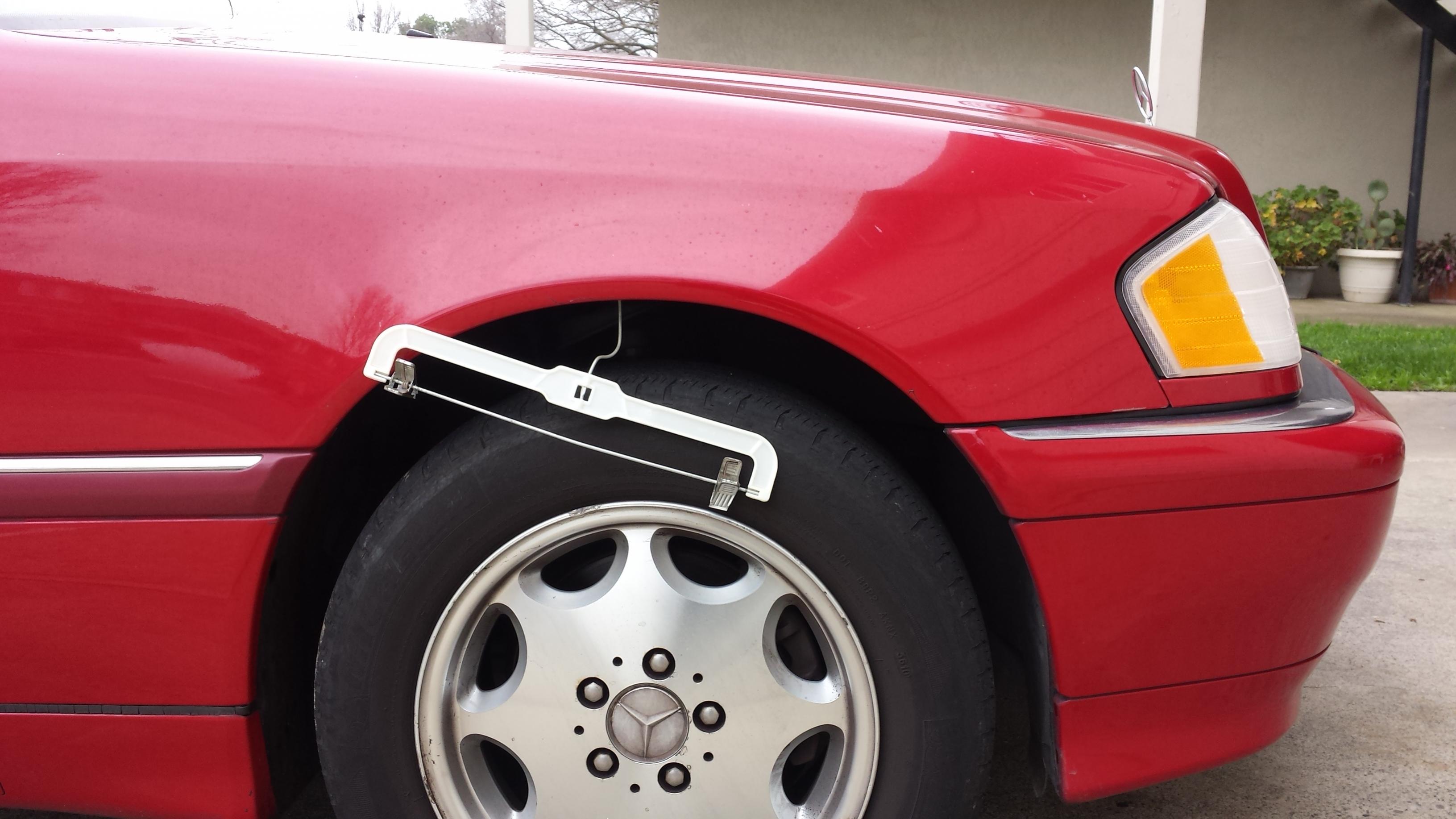

It could have been replaced before you got the car. They look identical to the eye. The only difference is the rolled inside of the lip.
Its the same fender

+ looking inside the amg fender its distinctly obvious its been rolled as they stop the roll well before the bumper join, if you go too far with the roll you will pull that area inwards it doesnt look so good.

Heres an example of an unrolled fender. This is my sisters 98 c230. I cant hang a hanger on the inside of my fender like this
