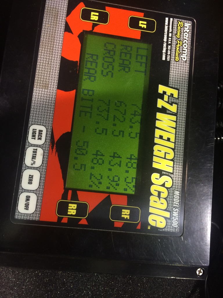

Hi all so I went to a friends garage to corner balance my car and it went well but ill do it again before I go to the ring
We managed to get a 48% cross weight with very litter adjustment just need a little more weight on the left rear

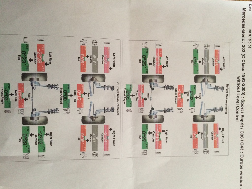

Ok hear is my aliment for the nurburgring got just about enough camber on front, rear camber iam really happy with as I have no adjustment for camber on rear. I would liked to have more castor but then I would of had rubbing as it is I have no rubbing

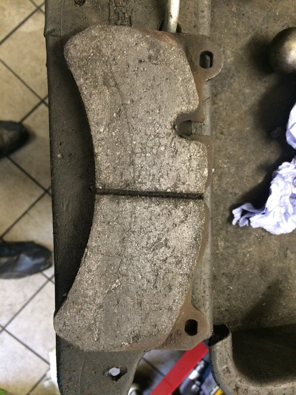

My suspension is fine I put the car on the ramp to give it a check I only have problem with brake vibration my front pads are gone so need a rotor skim and new pads.

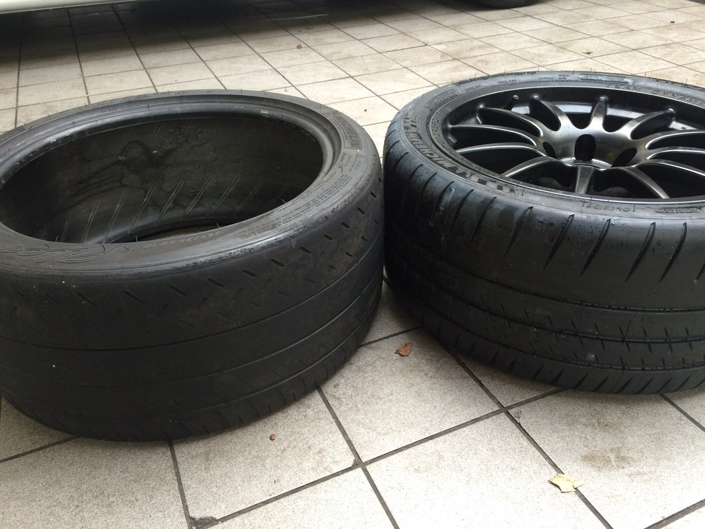

Just fitted the new Michelin cup 2 tyre to my car ready for a track day in a few weeks. First impressions is the cup 2 are miles better in the wet than the cups I was on a motorway run yesterday the cap 2 make the car feel proper planted and turn in is amazing. Cant wait to try them on track
