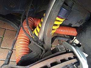

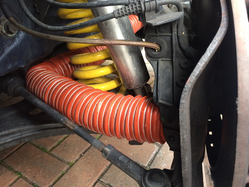

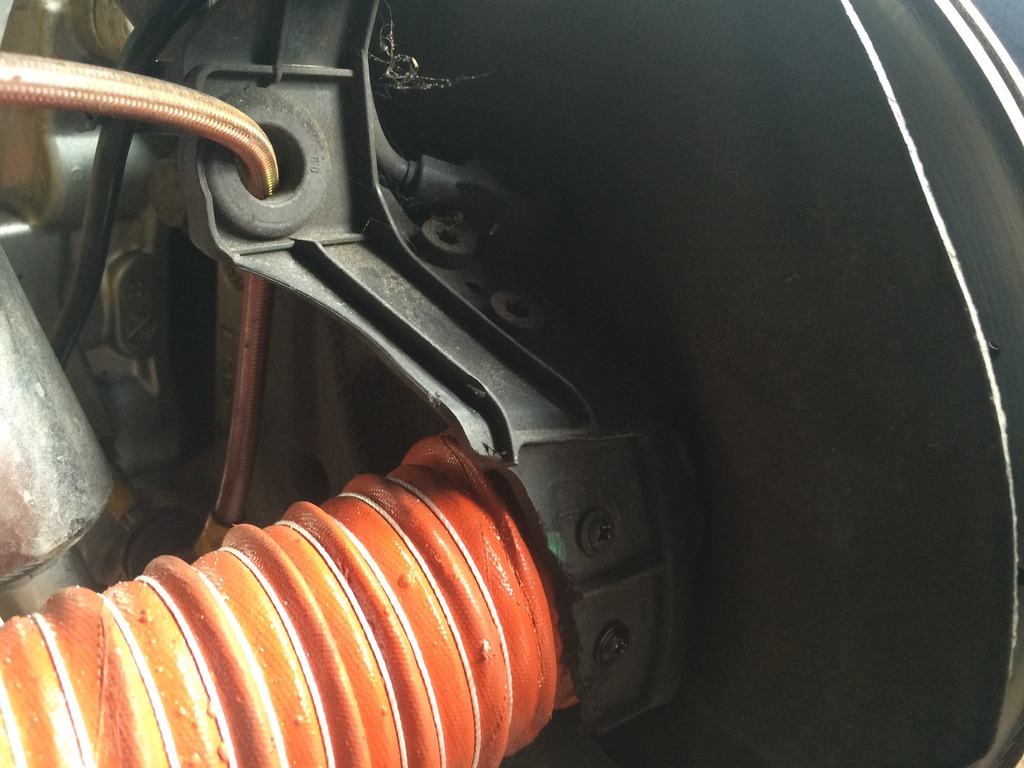

Hi all iam going to Snetterton on Monday for a track day with my w202 C55. When at the nurburgring early this yeah I overheated my brakes witch caused pad deposit transfer to the brake discs that led to vibration under braking. So I got to think that I should try to implement some brake cooling

nice ingenuity!
but just keep in mind that usually its the pad temps that get overheated at the track, not sure if pushing air to the bottom of the disks will do much for the pad temps. most high performance street pads top out at 800* or maybe 900*F then start to fade or cant properly expel the dust. i had to go to a race pad that can still operate around 1100-1200*
*edit... just read your sig... you have the pagid race pads and they still were givng you those issues?!? that seems strange to me.

Originally Posted by Dziner82
nice ingenuity!
Hi ive not used the pagid pads yet Monday will be the first time ill use race pads on track. I over heated the factory pads at the ring.
What the best way to bed in the pagid pads?
