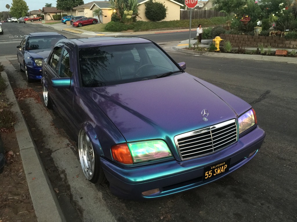

So most of you will probably hate me for this but I decided to pull the trigger on flaring the car to run wide tires. I actually like how the look personal I cut them to meet the body line they're also rocked forward a bit purposely to line the the rivets on the body and so that it tucks back in towards the rear.
Theyre not perfect but they will work for now. might end up doing metal flares welded on when I have the car painted.

"Low Cruise" Height

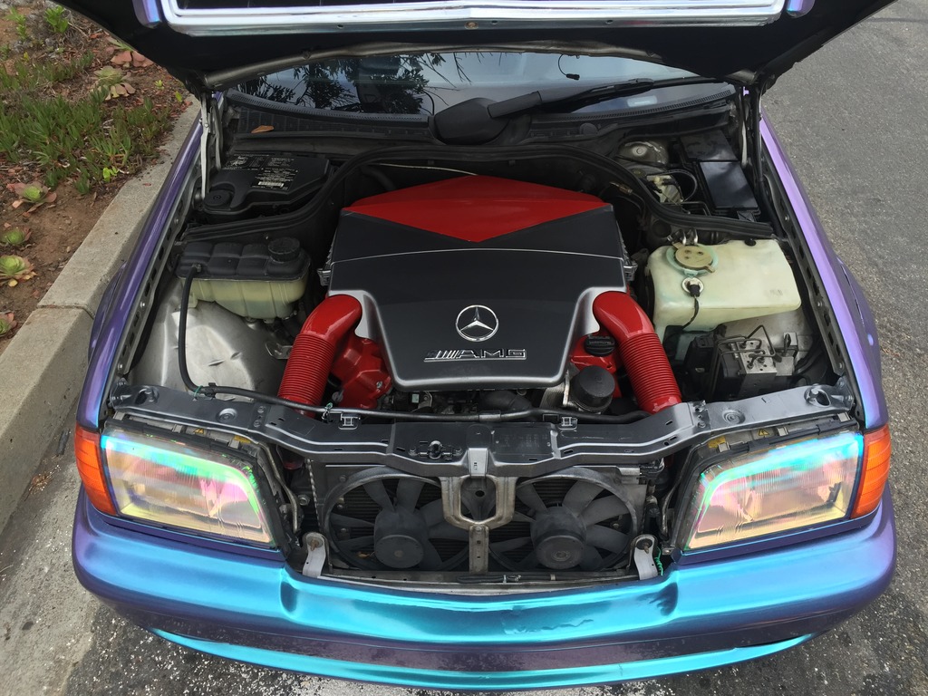

Painted engine cover

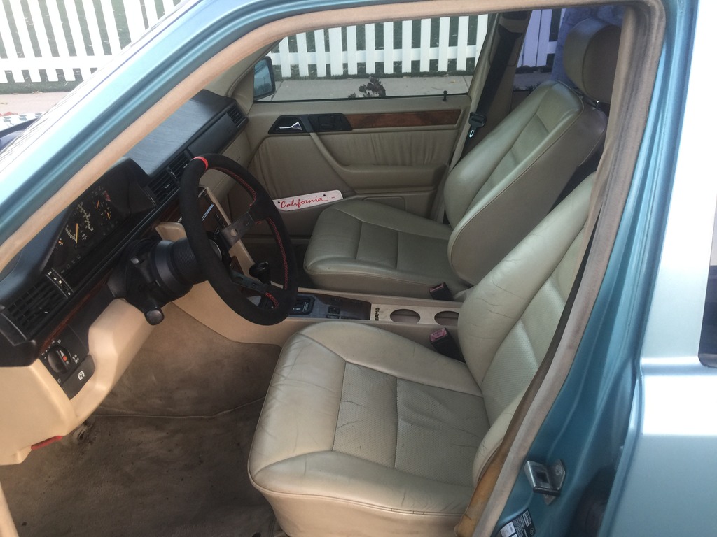

One more update for you guys, I picked up a new project / daily from a good friend I met through the car community. 145K miles clean title and a whopping price tag of $200 USD
There are a few small issues rear suspension has DIY aftermarket short camber arms , toe arms and push arms that make the rear end feel like its swaying nothing some stock arms cant fix, waiting to hit the junk yard this weekend for everything. Also the front drivers side wheel got pushed back an inch or two previous owner hit a curb on that side replaced all arms and suspension components but the frame will need to be pulled a touch, all in all for $200 cant beat it. Picking up some Brabus VI reps for it tomorrow and should have suspension / frame work fixed up over the weekend
Dom's C43 build thread (55 Swap)-576ebc87-b5f0-427b-952c-94fccb3c525e_zpsx5ffacsi.jpg
Dom's C43 build thread (55 Swap)-559a2d7d-37c0-4009-b841-4fcfe6a0de29_zpsftlcm4et.jpg

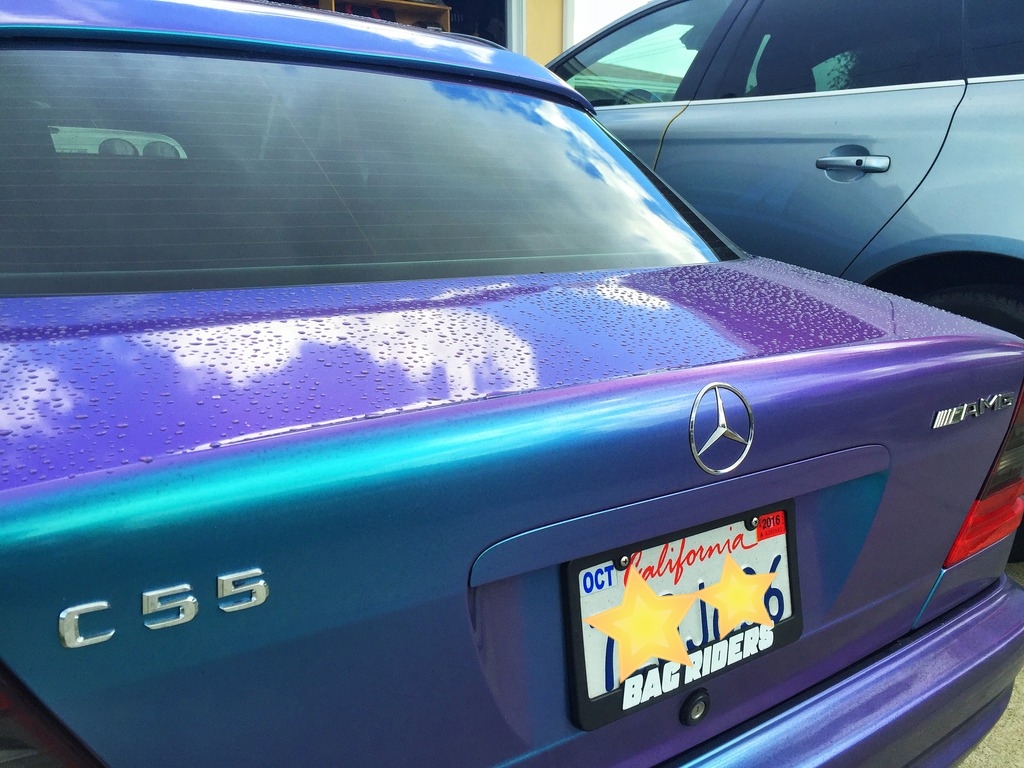

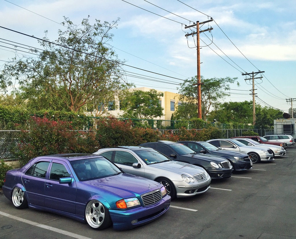

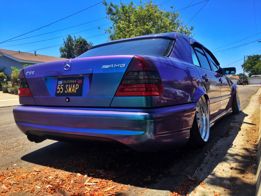

Not too much new going on right now but I finally got my custom plates i've been waiting for! and my buddy's finished 55 swapping their 210 wagons

Awesome! I've removed secondary cats, resonator and the muffler going to be adding an X Pipe and race muffler soon to get a little back pressure
Originally Posted by JohnnyRock
Dig it! Where did you score the fender flares from?
Thanks! They're actually ZG flares for an old datsun picked them up from a guy who makes them locally
Originally Posted by MarcusF
SoCal, who's doing the paint work, and where are they getting their supplies?
Its all vinyl wrap me and my friends did at the garage

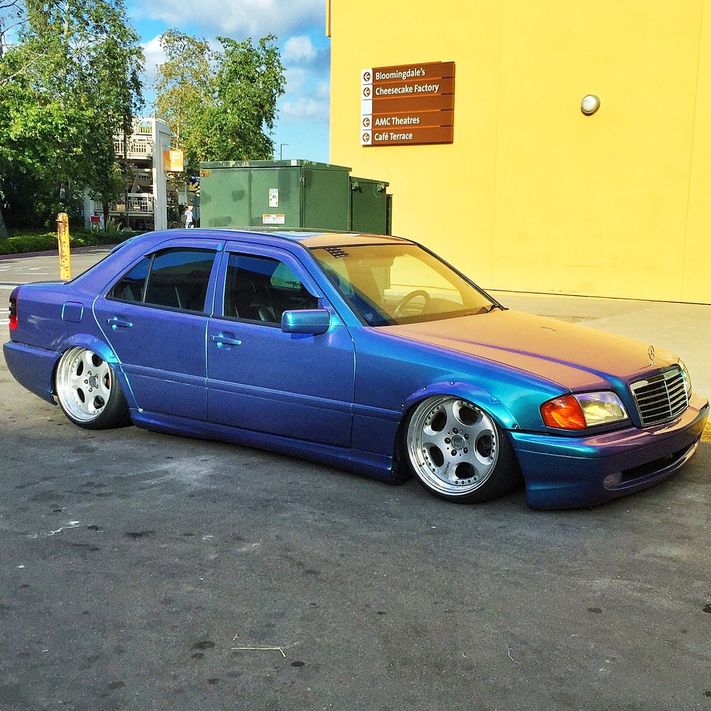

Originally Posted by kowalski
what size are your Brabus rims.
they look very wide infront
are they 18" 9.5 all 4 of them?
Theyre 18x9.5 up front 18x10.5 rear, +25 et all around fronts are spaced out 30mm so -5 offset up front. Waiting to do the same to the rears but need to run a full flare in the back for clearance. Eventually will remove the spacers and relip them larger but not for awhile. Planning on putting my 10.5's up front and relipping the fronts to 11.5 for the rear

9.5 in front with wide lips is FAT!
9.5 front wheels do they touch anything on full steering wheel lock?
did front wheels poke outside the upper part of the factory fenders before you bolted the wider arches?
did you get lots of stone chips around the factory front fenders from 9.5 wheels?
