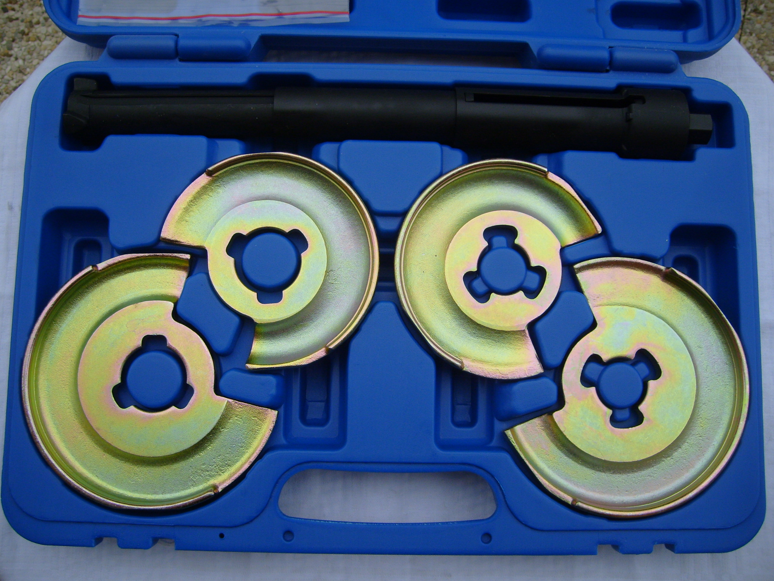

I strongly recommend for safety reasons you getting the correct MB spring compressor. It will always come in handy and you can find some good ones for not much money.
If you are changing all the suspension bushings, I also recommend you get new replacement arms. A full set for the rear suspension is less expensive than trying to remove the old bushes and insert new ones. For this job you may need to use a vertical hydraulic press and most people don't have that kind of equipment.
If you are doing all the rear suspension, then I assume you will drop the sub-frame. Once the frame is out, I think the 4 bushes can be replaced easily. That will certainly firm up all the rear end.
If you have any other questions, just shout
Attached Thumbnails What tools do I need for a complete suspension rebuild?-s7002856.jpg   What tools do I need for a complete suspension rebuild?-s7002857.jpg

I just removed all the suspension from my parts c43 car on all four corners and I did it with basic ratchets and wrenches.
Honestly the most annoying part of it all was the dangling heavy *** calipers always in my way. On a parts car I was able to remove them and drain some fluid but I dont want to do this on mine coz I dont want the brake flush to be on my to do list at this time
That sprint tool is good but how often will you use it??
Id go to your local auto zone and see if they can load you one.

but how did you disassemble everything without springs popping out and doing damage (or killing you)?
plus I have my wife's w124 that needs an entire rebuild, too. $70 for a spring compressor to avoid possible death or hospital sounds okay.

Took off the rotor and caliper, took out the shocks, put a floor jack underneath where the control arm is connected to the frame, pulled the two bolts out and lowered the jack. If you have lowering springs you can take the spring out once the shock is taken out. No need to take off the control arm.
When taking out the shock, put the jack under the front of the control arm and raise it to where you can take out the shock. Once the shock it out just lower the jack and the spring will slowly decompress

Ordering the full rear arm/bushing kit from FCP Euro but I've noticed some big nuts and bolts back there that I'm not sure I have the right wrenches for. I bought a few weird ones based on what I could figure out (XZN 12, a 16mm, 17mm, 18mm, and 19mm ratcheting wrench set) but I think some of them are bigger still.
Anyone know what else I'd need? Anything bigger than a 19mm? I also got the spring compressor.
I'm fairly certain I can replace all 10 arms in the rear without dropping the whole subframe but dropping the subframe is in the cards for the future so I can do diff and subframe bushings. But keep in mind I'm doing this with jack stands and a floor jack; I don't have a proper lift. I may save dropping the subframe for a future job but I want the car to be road-worthy for now to be my backup car. I just did all 4 shocks this weekend and noticed one of my rear-upper-forward suspension arms had completely shot bushings and was the cause of the crazy self-steer issue I've been chasing for years. The cheapskate in me wants to just replace that single arm but I know I'm stupid if I don't replace them all at the same time.

Youll need a specific tool to push out rear control arm bushings. Dont even start the job without it, itll be impossible.
