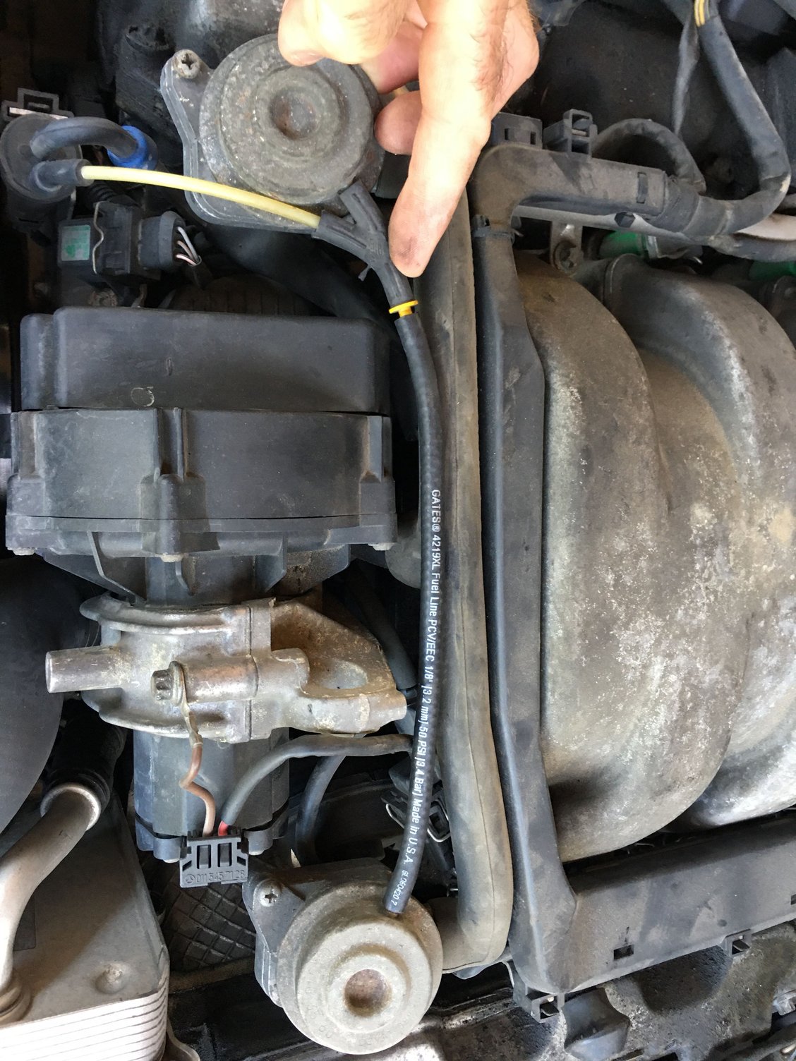

Hi all - I've been north of the border in Canada the last couple weeks, just got back. Found a vacuum hose that was rotten (see pic, the top of the hose seemed fine, when feeling underneath is when I felt the rot, seems like due to age/heat), replaced it with fuel hose as couldn't find the right vacuum size anywhere. Problem still happening. Ordered new gas cap gasket and oxygen sensor from autohausaz, will report back after I swap those out. Thanks again for your knowledge.
