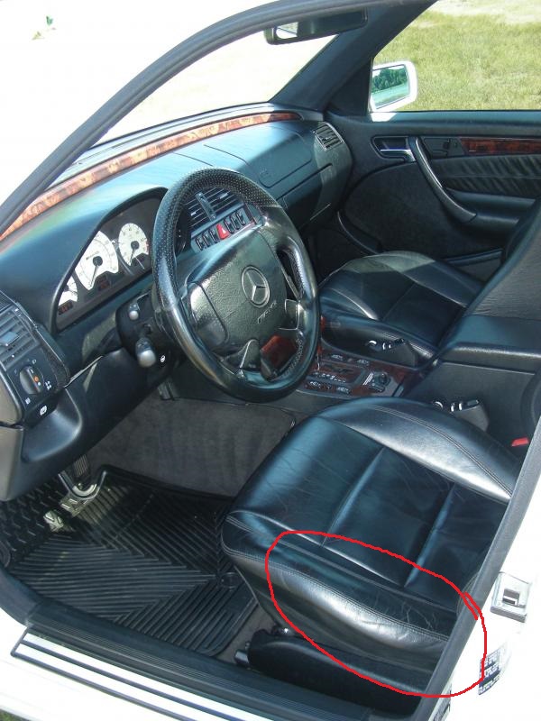

The driver one sagged a bit. the seat has that stretched out look

What does a saggy seat look like? Cant say ive seen that!

Like this for example. This is not my car

On the outer edges?
Only issue i see there apart from the steering wheel being on the wrong side of the car is the dash inserts look silly with wood on a C Class, especially compared to the grey patterned AMG dash inserts.

this...

Yeah thats what i thought you meant.

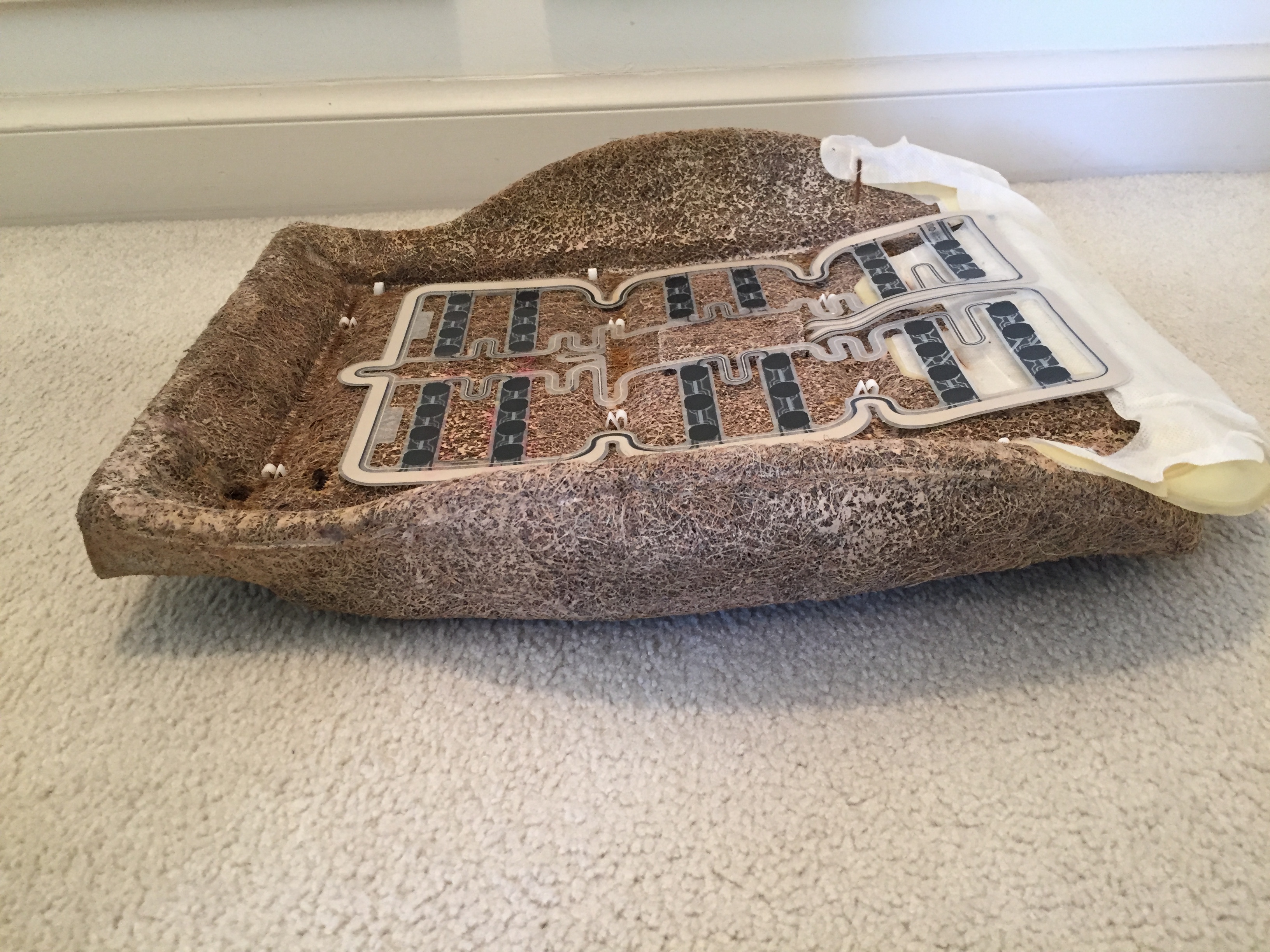

That sort of "sag" could be from a deteriorated fiber pad, not necessarily the spring. The fiber pad is what gives the seat it's final shape. Look at the spring assembly. There is no support for the side bolsters. The support comes from the fiber pad.

Any pictures of this fiber pad? I kind of had this in the back of my mind but didnt think anything other than metal would retain its shape like that over time.

Here are some photos. This happens to be a passenger pad, with the seat occupied sensor. Also, the white part at the front is the knee bolster bladder.

Oh I see. Now this part has to be specific to the amg seats no? they have more of a bucket seat look to them

Yes. The spring unit is the same for all W202s. The fiber pads for the W202 (and in fact, all M-B) are model specific.
