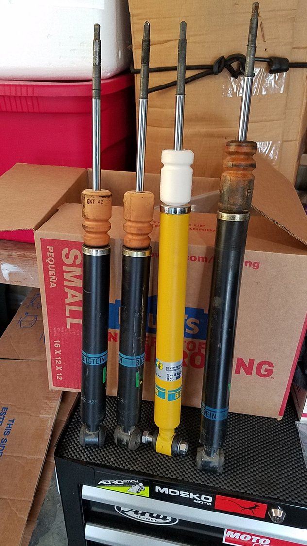

I'm not believing these can be the preferred option with H&R 29749 springs. When i changed the rears the shocks were very obviously shorter. These are much longer. Almost like the B36-1855 (rear) and the B36-1854 (front) are mixed up.
Can anyone confirm I'm not crazy or that I was delivered erroneous parts? Thanks for this first bit of help. AMG fronts on the left... bilstein B36-1854 middle... and AMG rear on the right.

Very weird as even in the Bilstein on-line catalog, neither the C36 or 43 are mentioned....
http://web1.carparts-cat.com/default...5018004&12=102
Checking in the CLK w208 page, the 55 is mentioned. Don't know if these fit though...
http://web1.carparts-cat.com/default...04&14=4&12=130
However, when typing the code 24-018548 it does show up in the catalogue but unfortunately doesn't identify for which vehicle. I'll let you search around some more...

For Bilstein sports (yellow sleeve):
Shocks (w208 430/55)
Bilstein Sport Front - F4-BE3-2599-H0 | Manufacturer Part #: 24-025997
Bilstein Sport Rear - F4-B36-1855-H0 | Manufacturer Part #: 24-018555
I have these and confirm fitment.
