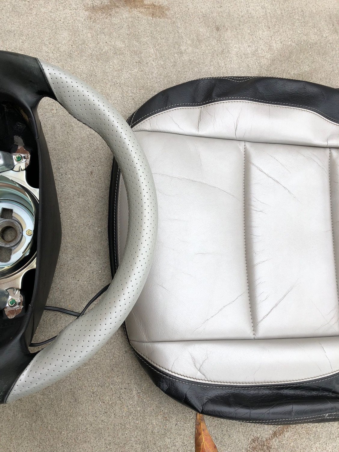

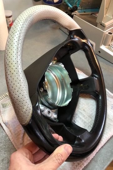

Christmas holiday project: re-dyeing my steering wheel and shift knob. So far, so good! The color and metallic finish are very close to the original. I am using Leatherique Mercedes Alpaca Gray and a couple light coats of Leatherlab+ Mercedes Designo Silver. I taped off the black stitching when re-dyeing the silver part. Now, I must redye the black part of the wheel. Stay tuned for the finished product.

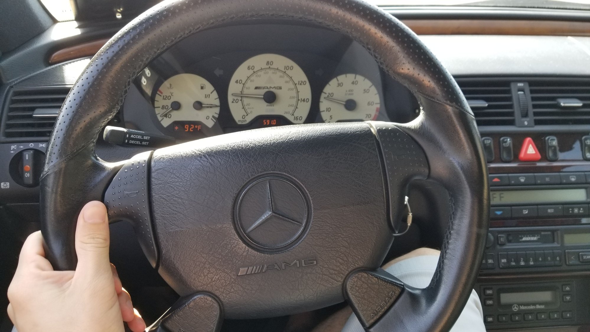

Before. The silver part was wearing off, and the black part had a bunch of scratches. I used Leatherique Super Prepping Agent and 400 grit sandpaper to remove the original dye. I also spent some time cleaning out the perforations.
I used an airbrush to spray 2 coats of Mercedes Alpaca Gray followed by 2 very light, mist coat of Mercedes Designo Silver. Finally, this was clear coated.

Originally Posted by eFifty5AMG
Awesome, nice work! Does it match the seats well?
It does IMO. As close as its going to get post-factory. The Alpaca Gray is a close shade, and the Designo Silver adds the metallic effect. I think anymore Designo Silver other than a couple of mist coats would have made it too dark. Must remember that the old seat cover is going to have more of a metallic effect because its worn.

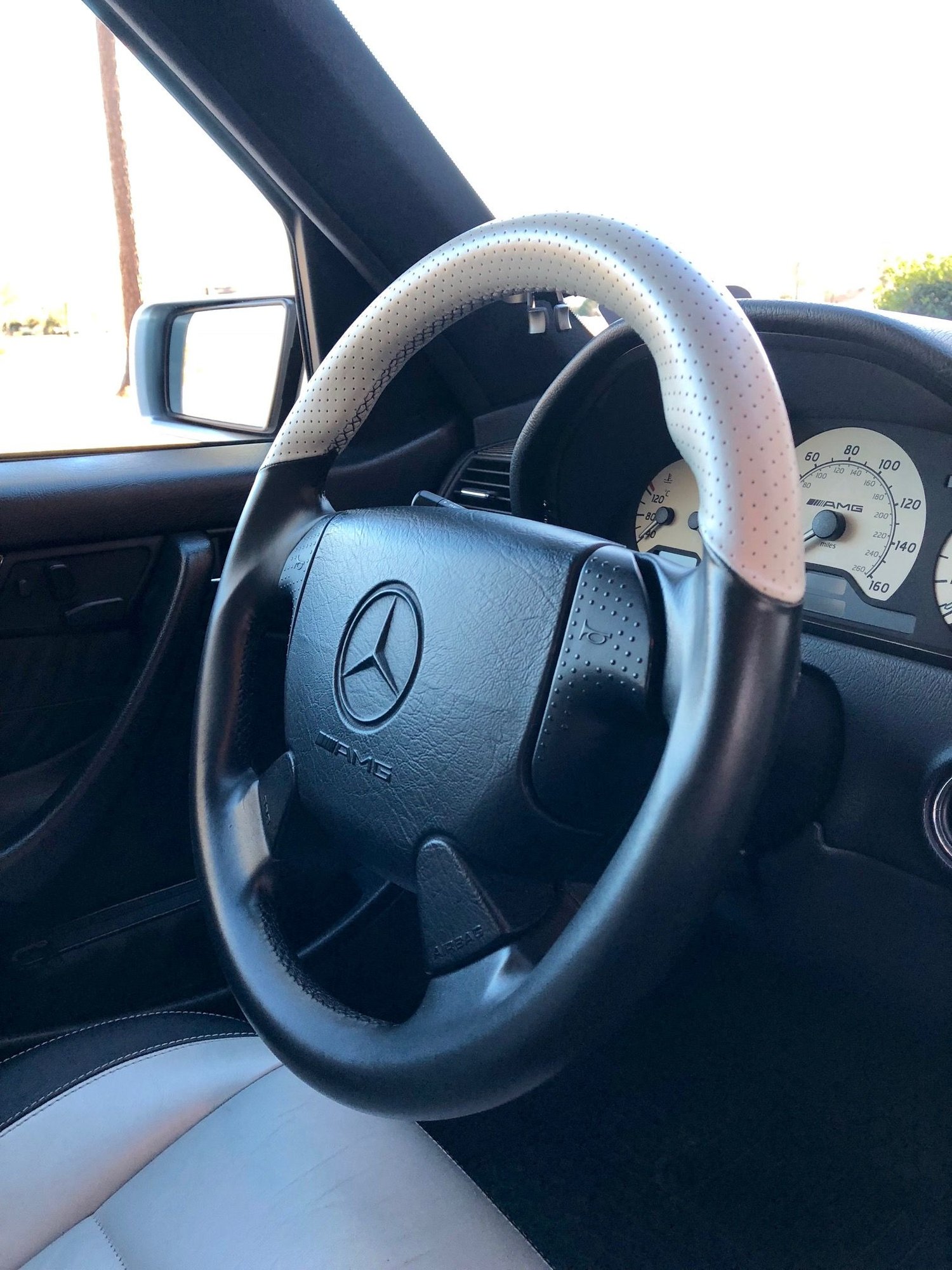

And finished! I'm quite pleased with the result.

Great Job!.. I have to ask.. How did you keep the stitching like that after re spray?
Old Jan 9, 2018 | 09:29 AM
BVC500's Avatar
Joined: Oct 2002
Posts: 201
Likes: 25
From: Washington, D.C.
2016 GLC300 & 1991 500SL
I taped off the black stitching during the respray of the silver part. I ran some thin strips of tape along the length of the stitching. I didn't have to do that with the rest of the steering wheel because I sprayed black over black stitching.
