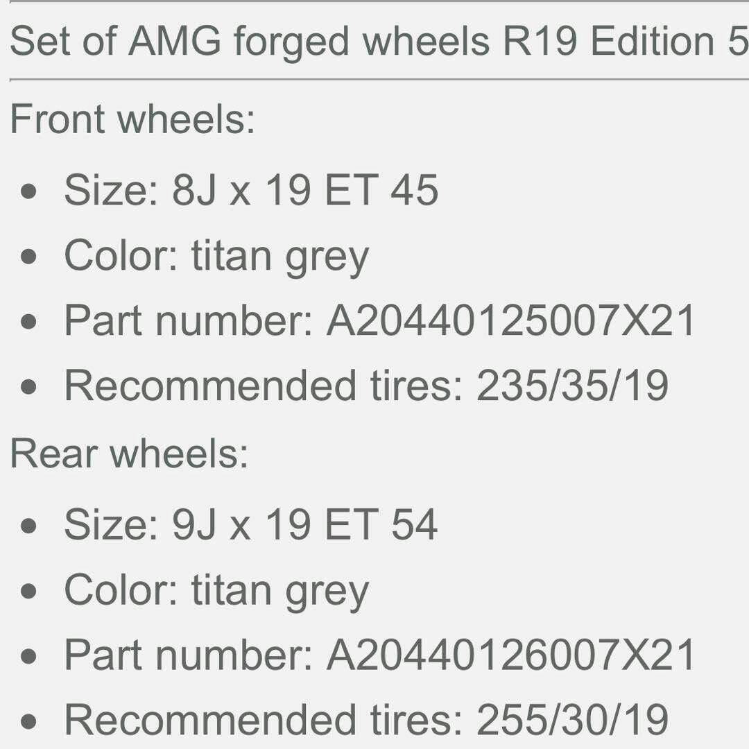

Hey guys, wondering if these will fit my 2016 c450? Was thinking about buying them but only if they fit well on my car.
I appreciate any and all input! Thanks!

Definitely need spacers in the front to fit, at least 10mm if not 12mm to get offset down to around 32mm. Rears will be fine.
