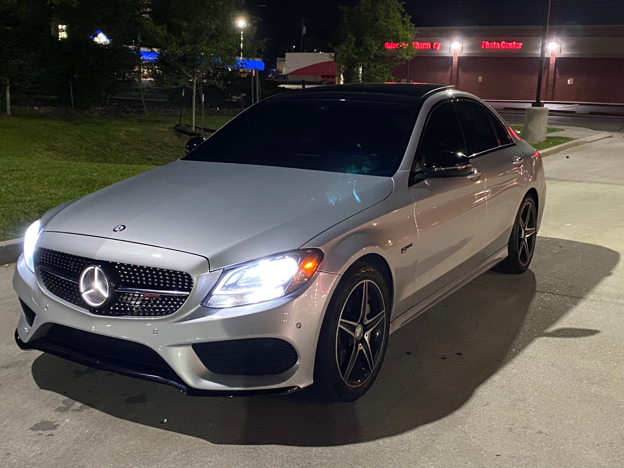

I was thinking about the dinan as well, because I’m not gonna race the car or anything lol. I have the MST installed and I love it. They redesigned the original so it’s not totally enclosed, but the vents up near the hood shoot cooler air into the MST box keeping it cooler anyway. I can totally feel the difference. I would highly recommend it over the BMS, considering it’s sucking the same hot air the engine is letting off, it’s getting more air, but it’s cooler. Dinan is a super reputable company, I figured they’re mods would be great. Does the pedal feel better? The pedal response in these cars is awful!

Old Jul 27, 2020 | 01:56 AM
gpouliniii's Avatar
Joined: May 2020
Posts: 183
Likes: 24
C450 AMG
We have the exact same car. Except your deck lid spoiler.
Old Jul 27, 2020 | 10:45 AM
C43Insane_XXX's Avatar
Joined: Jul 2020
Posts: 67
2018 C43/ 2016 C450(RIP)
I gotta get a nice lip like that. And you have the lit up emblem. But as far as the pedal response...it's a whole lot better. I feel the pull as soon as I hit the gas. The only thing that is still there is the lag when you don't make a complete stop. Usually down low in 1st and 2nd gearing. I just use the paddle shifter though when I expect not make a complete stop.
Pretty disappointing. Also, I thought the speed limiter would have been bypassed with a piggy back, but it's not. Eventually I'll get a ECU tune.
I'm also going to try the MST intakes.
