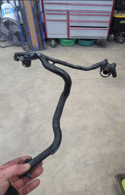

Reporting in at 162,028 miles. Just had my local redneck shade tree mechanic help me on a replacement of the A.O.S. (air oil separator) yesterday, since we noticed a dollop of engine oil under the passenger side engine air filter - while doing a routine interval replacement of a (NGK) set of spark plugs. I took the opportunity to buy the AOS and some camshaft magnet cover O-rings (from FCP Euro) to proactively replace when he was in there for the AOS. I would attempt the D.I.Y. repair myself, except I'm not proficient in the mechanic skill tree, nor do I have the patience & or tools/know-how to deal with bad mojo when things go wrong...and wrong it did go. The good news: we did not use the O-rings, as the covers were totally clean & without seep. The bad & ugly: when our redneck hero went to remove the AOS, the connecting crankcase breather pipe disintegrated in his gnarled hands at two different points (namely all three connection points). That necessitated an impromptu trip to the local stealership 40 miles away to retrieve another breather pipe replacement for a bit more than FCP Euro pricing <<small tears trickle; wallet empties>>. The heat cycling cookout of my 162,000+ miles had made for brittle and crumbling plastic that could not flex when my esteemed redneck wrench rassled those plastic evil eel pieces. I'm posting this (warning) for my C450/C43 brethren that trudge onward towards their own high mileage expectation...beware of the plastic fantastic nightmare that lays ahead.
Redemption was that the AOS was indeed plugged up pretty good - and the crankcase breather pipe ALSO had stress cracks prior to the wrestling session that were not immediately visible during prior "on lift" inspections. I had previously experienced intermittent "popping" of my engine oil dipstick (only about an 1/8' to 1/4" out; maybe 50% of the time I would check each week), accompanied by a faint "oily" smell after immediate shut down after the daily commute. I had previously associated the oil smell to an instance of an oil change gone horribly wrong - where the shop (a reputable one, not Jiffy Lube) happened to leave off my engine oil cap on top of the motor, and shut the hood. The story was one tech distracted the other while he was finishing up. A longer story for another time, but needless to say the car survived, never threw a light on the dashboard despite driving 10 miles home without a cap & blowing about 1/8th of a quart ALL OVER the underside of the hood & bathing the passenger side turbo, suspension, etc. The shop gently power washed top, bottom and sides - but on the ground and not up on a lift...so I figured there was a residual mess. Until we did those plugs and found the oil under the air filter element. Things that make you go "Hmm" and "Dammit"...

For my torched crankcase breather pipes - the "cracking" plastic was on the engine or interior side of the pieces - meaning the plastic exposed to the hot engine side (inside) was the most dried and cracked portion...not visible until you pull it away from the engine. I was trying to monitor the appearance of the pieces previously, but of course the exterior of the plastic looks just fine from the outside! I never thought to pull them away or look on the backside of them. It's the inside portion exposed to the block and proximity to the turbo(s) that gets fried obviously. Breather pipe was $150 from the stealership.
I also agree that having the transmission serviced by the professional (Indy) shop is the way to go. My next interval is 180K, so maybe in 9 months from now (Dec 26')? Last time was $600.
My engine oil consumption is also right around 1/2 quart for 5,000 miles. It was double that with the plugged AOS/cracked breather pipe combination though.
