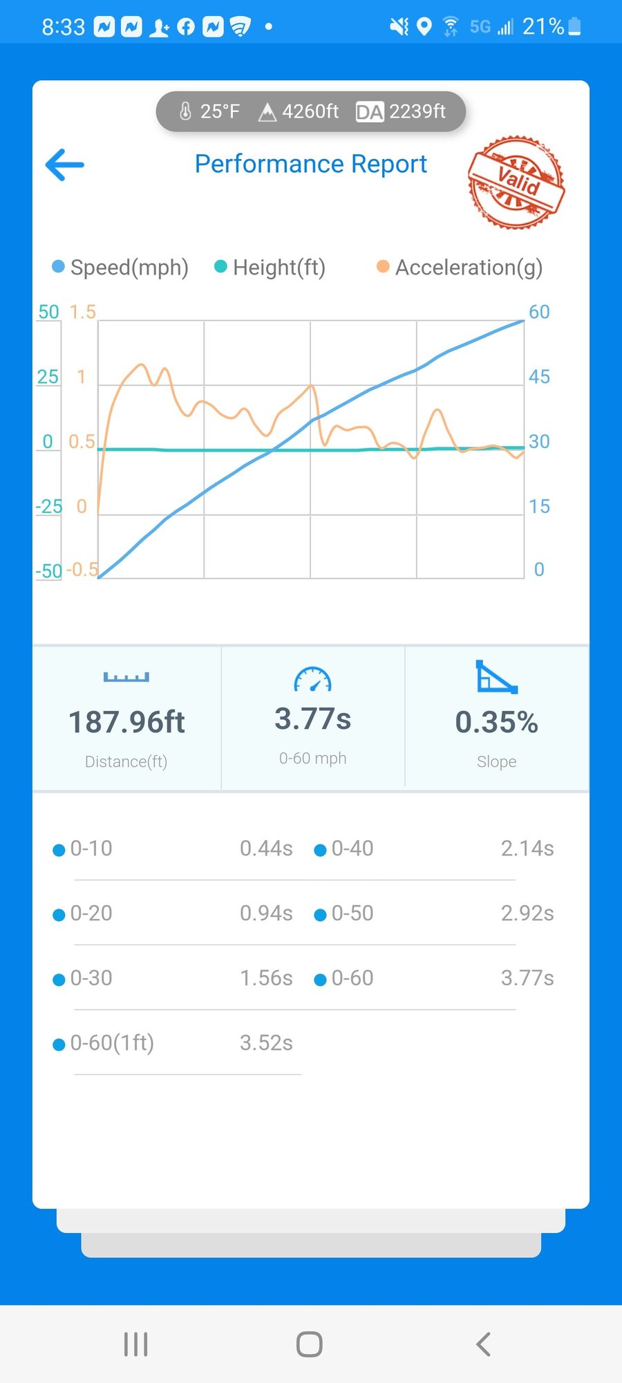

Update on a draggy pull!I kept running a consistent 4.09 0-60 on map 2. I would brake boost for about 4 seconds And the launch felt great with zero tire slip. My goal with map3 was just to break in to the high 3's When I tried to launch the same way in map 3. I was getting too much tire spin and the car was shifting into 2nd gear prematurely. 0-60 was 4.4 Well I just tried another pull this time only break boosting For maybe a full second. Zero tire spin. Crushed my 0-60 expectations
