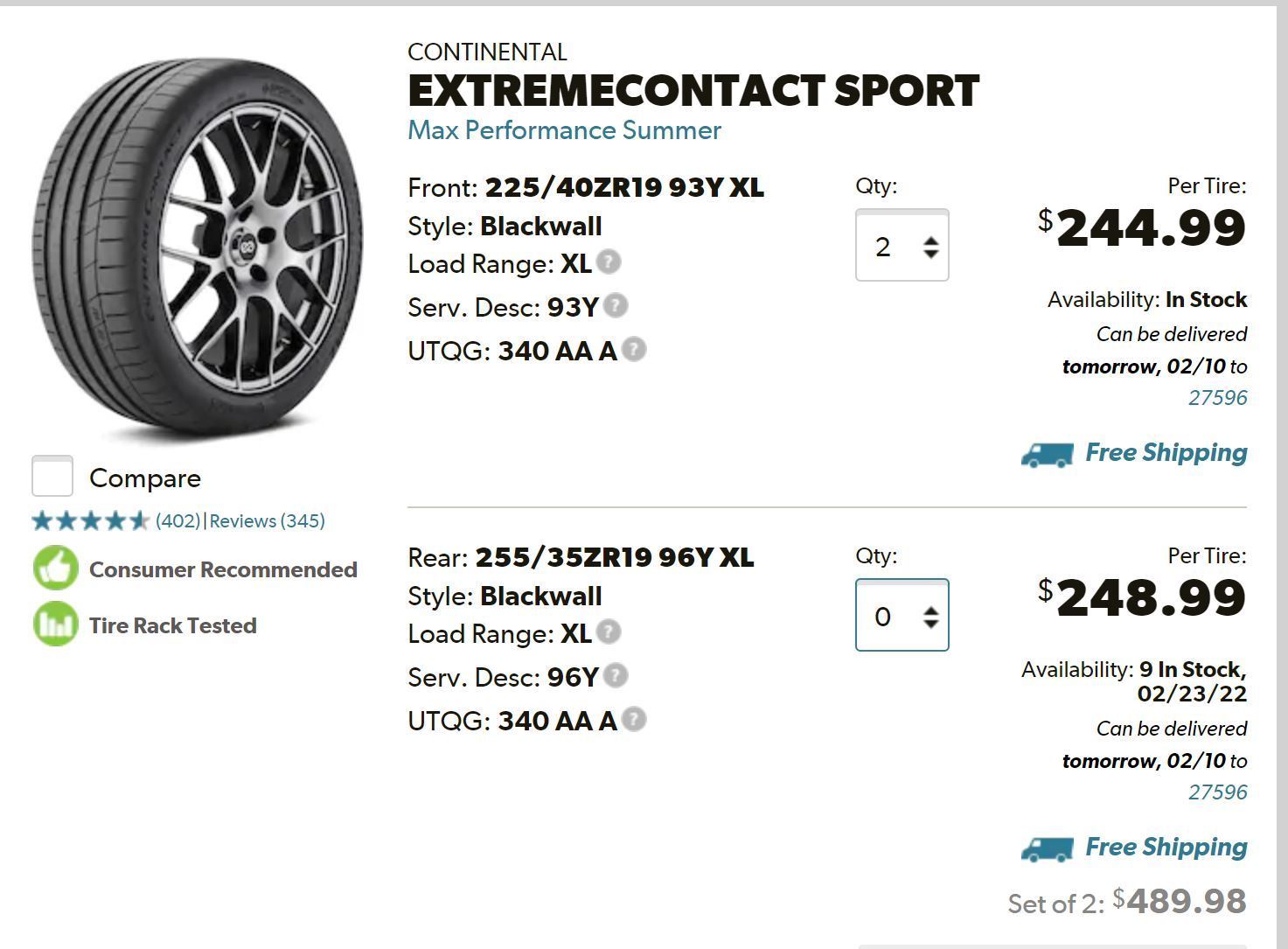

For the record , MB provided a quote for $851 OTD for two OEM replacement tires mounted and balanced - not even with an alignment wowza.
Going this route most likely:

Old Feb 9, 2022 | 11:27 AM
alexasa's Avatar
iTrader: (1)
Joined: Mar 2016
Posts: 3,263
Likes: 701
c
love those tires. If you're not going PS4S - those are the best tire for the money.
