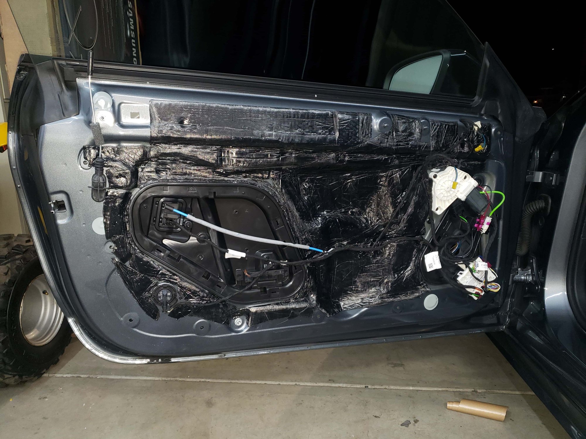

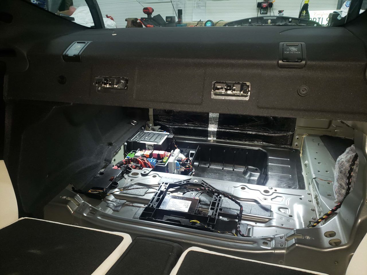

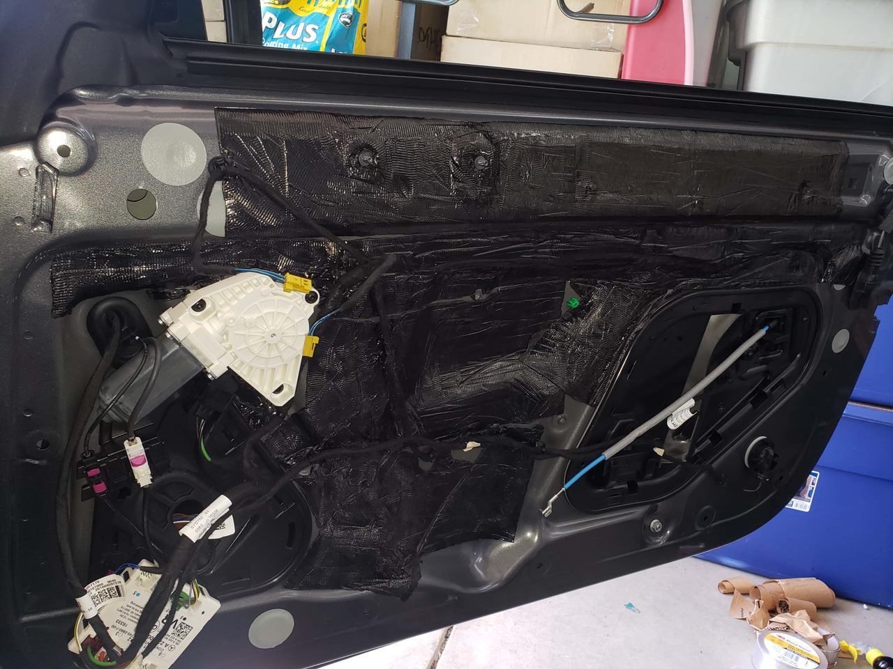

I too was unhappy with my cars sound levels and ended up adding more insulation to all the doors, the rear passenger area, the trunk floor, inside the rear wheel wells, and the two plastic underbody panels of the car. The car now has the noise levels you would expect of a higher level Mercedes.
With respect to squeaks and rattles, I would suggest removing the center console and applying cloth tape to all places that connect plastic to plastic. I covered all clips and mounting tabs throughout the assembly. Also, remove the outer chrome band and back it with the cloth tape.
Additionally, I run non-RFT tires (DWS06 Plus) and that makes a difference too.
It took a lot of time and work to do this, but the results made it worth the effort. All-in-all I used a 36 square feet of dampening material and 54 square feet of 3/8" jute carpet padding for added sound absorption. Just returned from a cross-country trip and the transformation was a game changer.

Any estimate of how much all those materials weighed in the aggregate? I would love to see a db meter test of your car versus a standard c43 (same roads, conditions, etc.) to highlight the improvement.
Old Mar 8, 2022 | 07:46 PM
////AMG_C43's Avatar
Joined: Feb 2020
Posts: 81
Likes: 40
2019 C43
The dampener is listed as 24 ibs. and the jute padding lists for 12 lbs. I did the job in two steps and never considered trying to get a before and after reading. I have done the same thing on other vehicles and was confident that the results would be worth the effort. Pricewise, one of the best mods you can do for this car. Make that second-best; buttoning down the console should be fix number one.
